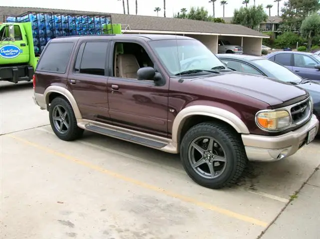

Does anyone know if a set of eagle 18" by 9 with a 23mm offset will work. or a set of corba r rims as there about the same except the eagles are chrome, and have a little nicer cut to the spoke. i just want them to be flush with the fenders and not hanging out. if anyone has this setup on there truck please send me a pic as i think these are what i am after. by the way my truck is a 2001 sport track 2WD. thanks alot
These are 18x9 +24mm....... your wheels will stick out 1mm more than these.

Thanks alot Justin. question did you haft to use spacers or anything like that as the rim guys i have checked with act as if the center of the hub on the sport track would not fit thru the center hole in the wheel. thanks for the pics as well they do look good on the explorer. i take it they will look the same on the sport tracks as the bodies are about the same
sorry also what size tires are you running on the 18*9 and did it affect your gas mileage good or bad. thanks again
If you are 2wd, you might have to run a 4mm spacer up front. I know the truck in the last picture is using spacers on the front-has a 265/60/18, while the others are 255/55/18. The very first picture could be a Photoshop, but I know for certain the others aren't.
