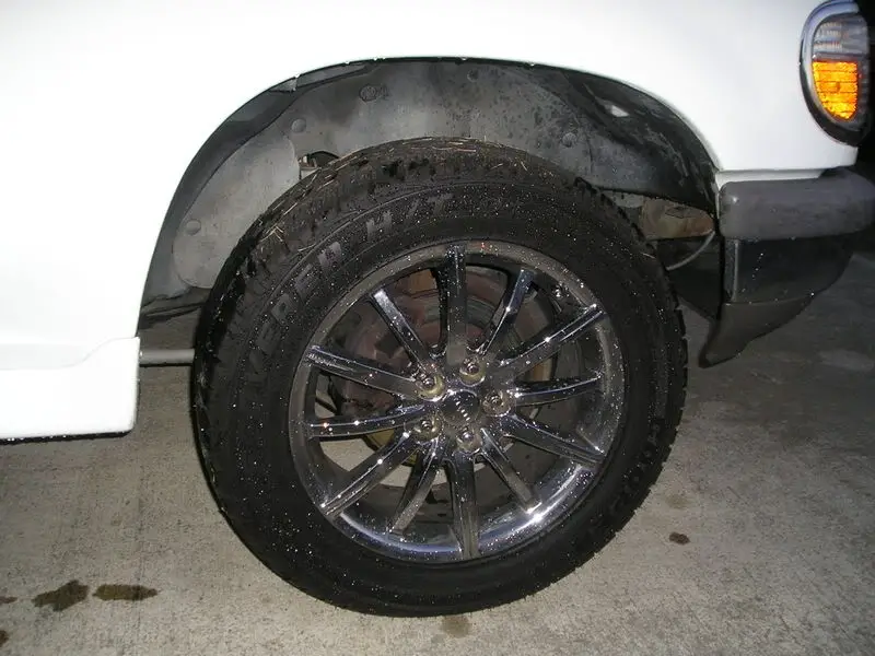

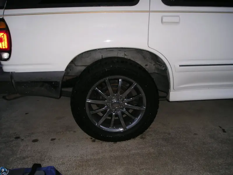

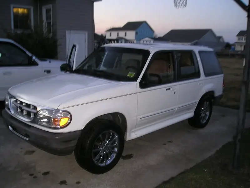

NO it would not be pushing it... I also have a almost brand new set of 18" Chrome Detata Rallye's with 2 month old Cooper Discoverer H/T plus 255/55-18 they came with the truck when I bought it Dec 15th 07...there yours for $650 shipped if your interested here are a few picks if you haven't bought wheels yet...
this is stock height on my truck but lowered a little bit then you'd fill the wheel wells nicely...
