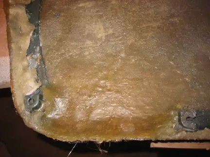

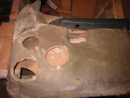

Looking great man it's going to sound really great up front. How many layers of glass did you put on the door?
doors have about 6 layers in the places where i layered them thick (only in the weak spots) otherwise they are just fleece. here are pictures

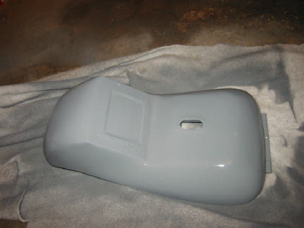

here is my 4" screen in my overhead console, i'll be adding led's to it next so i have a dome light type deal

and this one is for rydinhigh
do you have to worry about the tweeters heating up by putting them in the defrost vents? are you only going to use one layer of glass on the doors?Lookin good... when you expect this all done?

like i said, the doors got fleece everywhere, and layers (up to 5 or 6) in the couple of places that seemed weak. I'll be adding a few more layers yet around the speakers themselves so that it can't flex (probably 3-4 layers there). it won't take too much to make it stiff enough that my mids don't cause flex problems.
