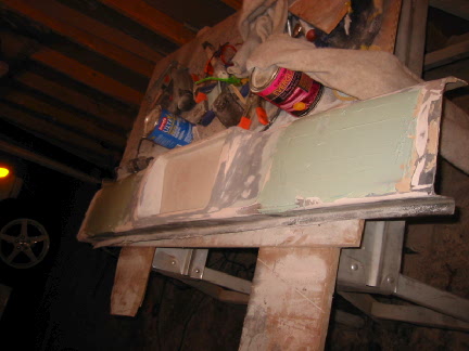

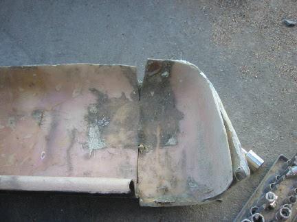

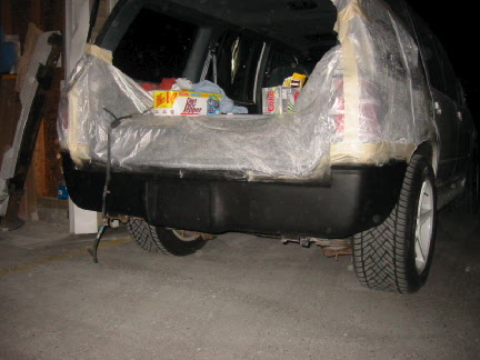

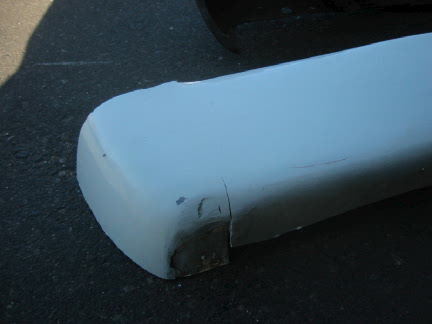

well, i got the rollpan in the mail today and got to work on things around 5 tonight.
sadly, it wasn't in quite as good of shape as i had expected. In my opinion the curvature wasn't good enough, the finish just wasn't good enough, and the mounting system wasn't gonna be strong enough.
I'll post some pics of it as i got it, and then some as i went to work at making it how i wanted it
more

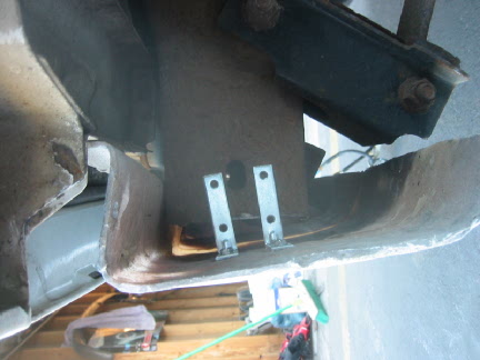

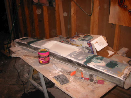

as you can see i decided to just chop it and start over on most of it-
added some brackets that bolt to the frame, and also glassed them into the bumper
i've really fixed the contour problem (it had humps where the ranger pan had been broken and bent to fit out contour) at this point, but i don't have many pics. they are sort of pointless when its not on the truck. i'll have it mounted tomorrow and i'll post many more

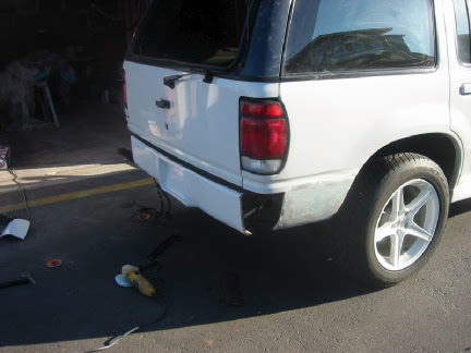

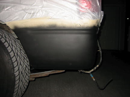

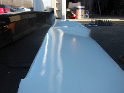

well, today i mounted the rollpan, laid 7-10 layers of glass on all the seams from behind (layign on my back under the car) then wait for 6 hours for it to set (its like 40 degrees here at best) then i laid glass on the front side and reformed the end caps with it and some creative use of tinfoil and duct tape.
all in all i did what i needed to do to still be on pace to haver her done

the issues with it were definitely not your fault in any way, and i'm very much a perfectionist when it comes to these things. the issues may in fact actually be my own "fault". that aside, it is workign out great, almost done, and it cost me less than the ranger one i'd have been modifying.
