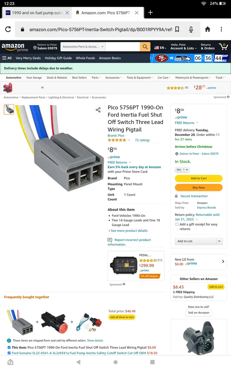

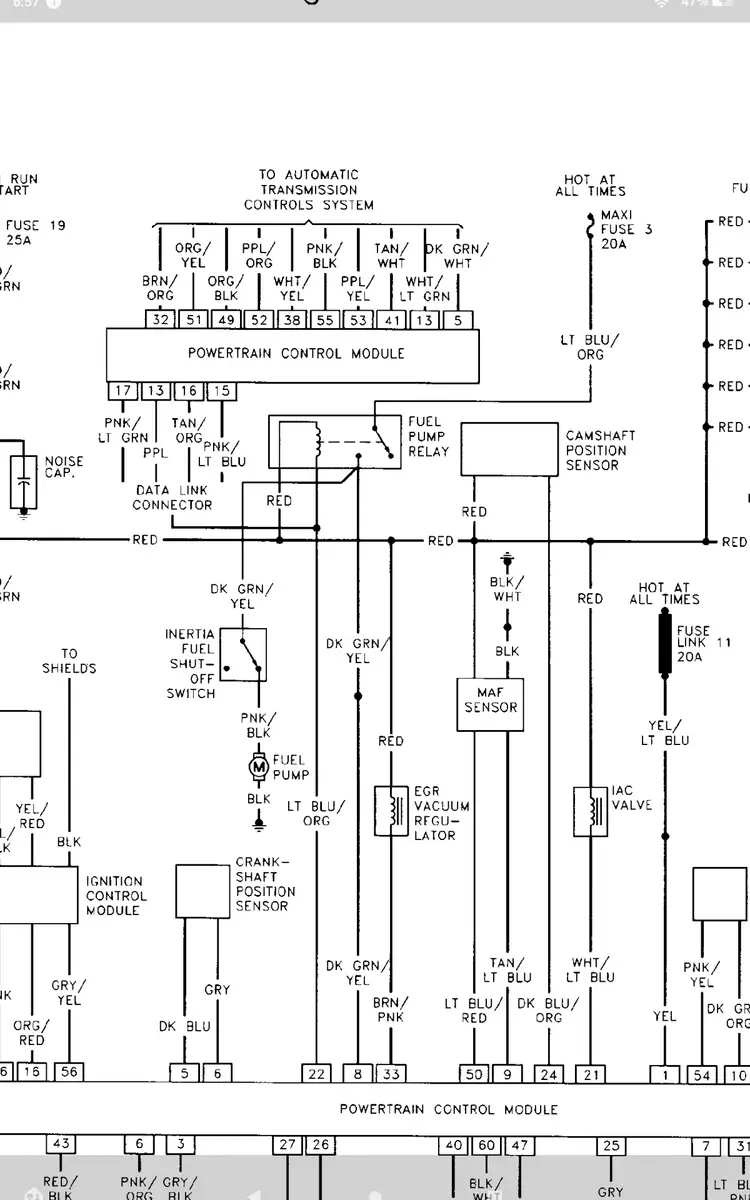

Trying to find the wiring diagram for the fuel cutoff sensor/impact sensor used in 1990 and later Fords of multiple models. P/n is "5L2T-9341-AA" and wiring connector "5756PT" has 3 leads. Does this sensor use 5VDC or 12VDC? What lead is ground/B+/? I'm wiring this into a new fuel system going into a '57 Chevrolet to cut off the in-tank fuel pump in the event of a collision. Don't want to fry the unit, but don't want to find out the hard way that I wired it incorrectly and it doesn't work.
