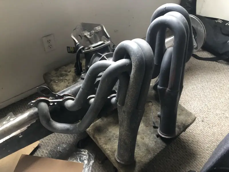

I Im going to be doing giant link killer leafs in the back , also ended up getting new motor mounts, and some over the frame rail headers but I need to figure out what I’m doing with the brake booster as far as relocation or manual brakes , or if anyone has experience in the brake part I’m open to ideas lol
Does no one make forward facing headers for the LS?
And thats all cause youre pushing the motor back so far?
Yes they do. Most are for turbo setups.
But you can flip the LS manifolds... intake and exhaust.
With stock camaro exhaust manifolds the flange sits in the steering box "notch" in the frame and directly over the passenger frame rail.

If youre going to be swapping out the patriot headers, are you looking to sell them?
I am still in the market for a set for my build.

These are the headers I’m going to try and run they came off a ranger with same swap

Those headers are going to look awesome on there.
