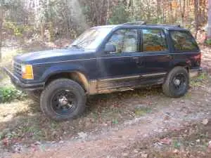

here is pic of front
side u can see the diff in lift
Looks good man.yea shackles will level that out

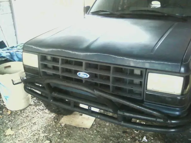

i wanna paint it flat black and i already tinted windows, and tinted turns, and painted a ranger grill black and installed
looks good , i liked it when i seen it for sale , would you consider selling that front bumper by chance ?
no sorry i didnt like it at first but it has grew on me it gives it that off road look seeing its got 8's on it. i was stoked when i got it the whole reason i never had explorer before is i hate automatics and finally found a 5 speed 4wd
here is front after i blacked it out

shackles installed it looks very close to level now, this was before i re-adjusted the shackles
this is final height for now, just need to find some 15x10's
