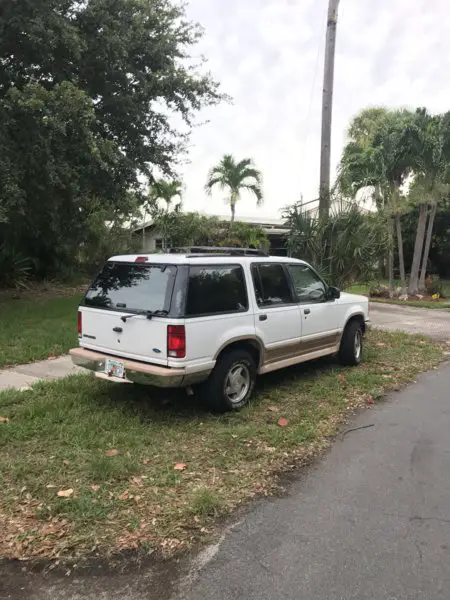

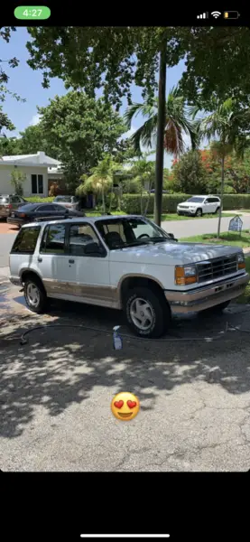

I had a 94 XLT in high school and now I scooped a 93 Eddie Bauer with 100k miles. Stored inside, 1 owner (family friend), in relatively great condition. Some pics below (she’s the white one)

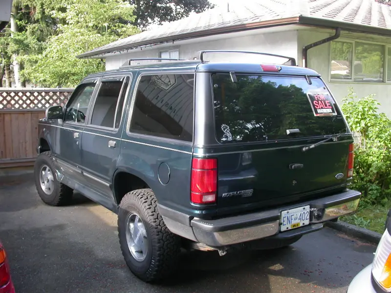

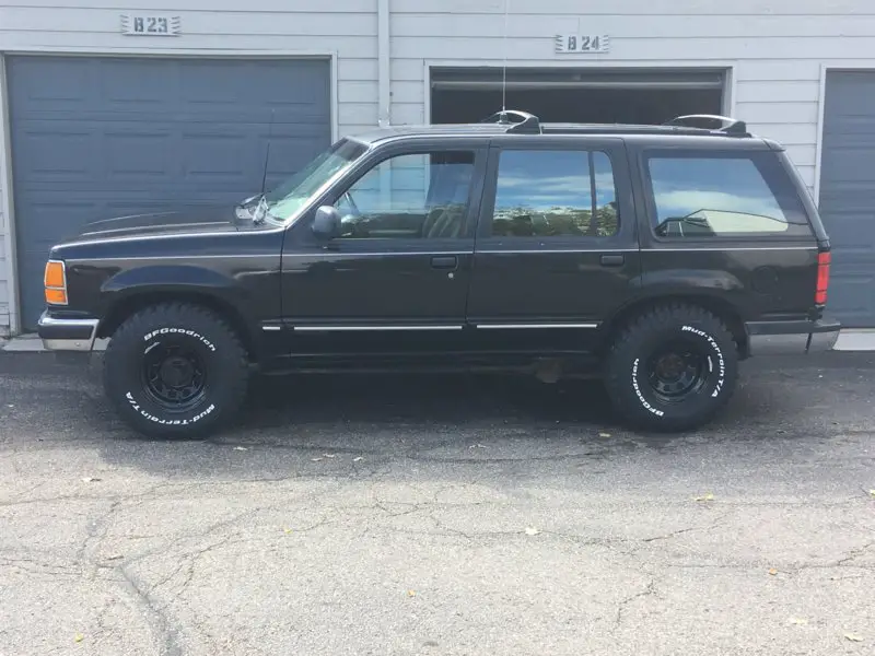

I would like to modify it a little to make it slightly more attractive. Nothing major. I have put aside about $2k to put into it (give or take) and I added a few pictures of what I would like her to look like.
Any advice on lift and wheels would be greatly appreciated! I know I need new strut bushings and front shocks (according to my mechanic)

2K will go a long way towards making it look right!
Are you okay with the white paint? paint jobs from white to green are lots of $$$$
Your explorer does not have struts, it likely needs new radius arm bushings and shocks
Time to consider a 1.5-2" lift kit
Basically you can get new front 1.5" lift coils and 4 shocks from Skyjacker, then run warrior shackles in the back and this will give you a nice 2" suspension lift.
All the other modifications pictured are just cosmetic, paint, wheels and nice off road tires

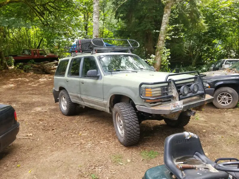

On my 94 explorer I put 2 inc pucks and a 3 inch Shack lift plus a 3 inch body this is a pic of it so far made and fond bumpers that I like and modified them to fit I have a brush gard of a 94 geep Cherokee that mi mad work

That is one goooood looking explorer!!!
