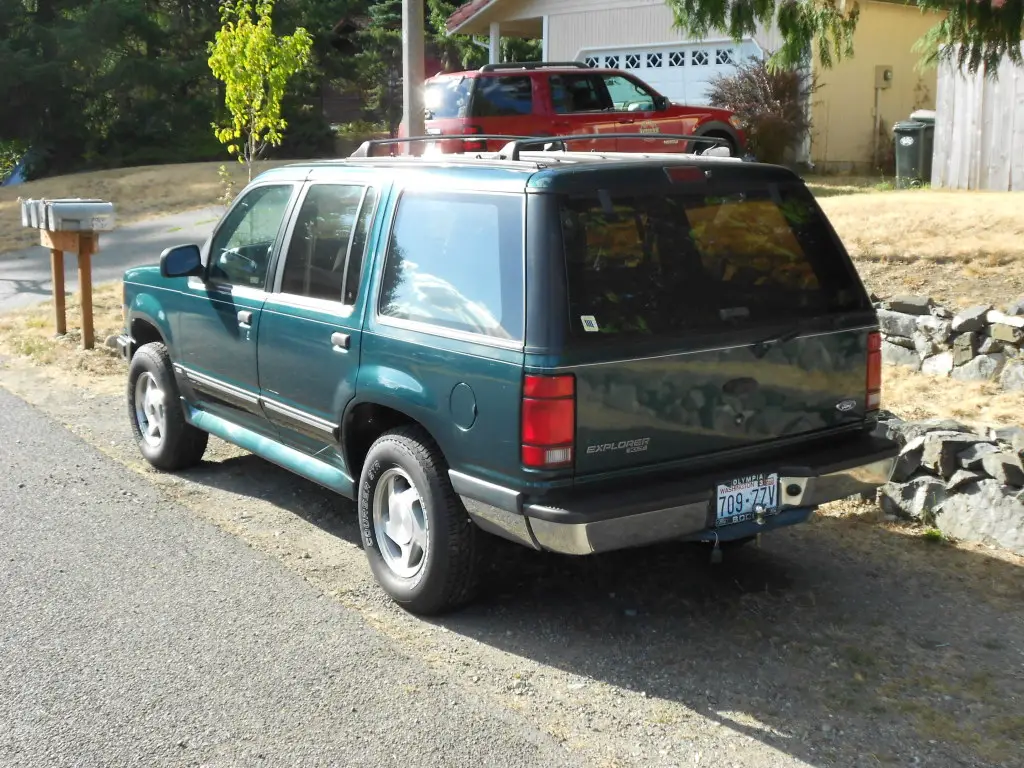

Enough yacking, here's the obligatory picture offering.
In better days

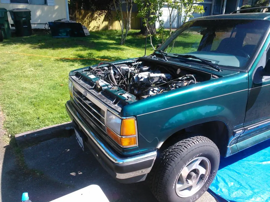

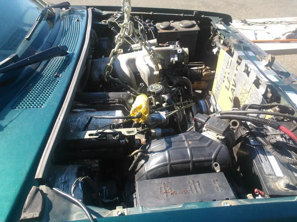

Strippin' it.

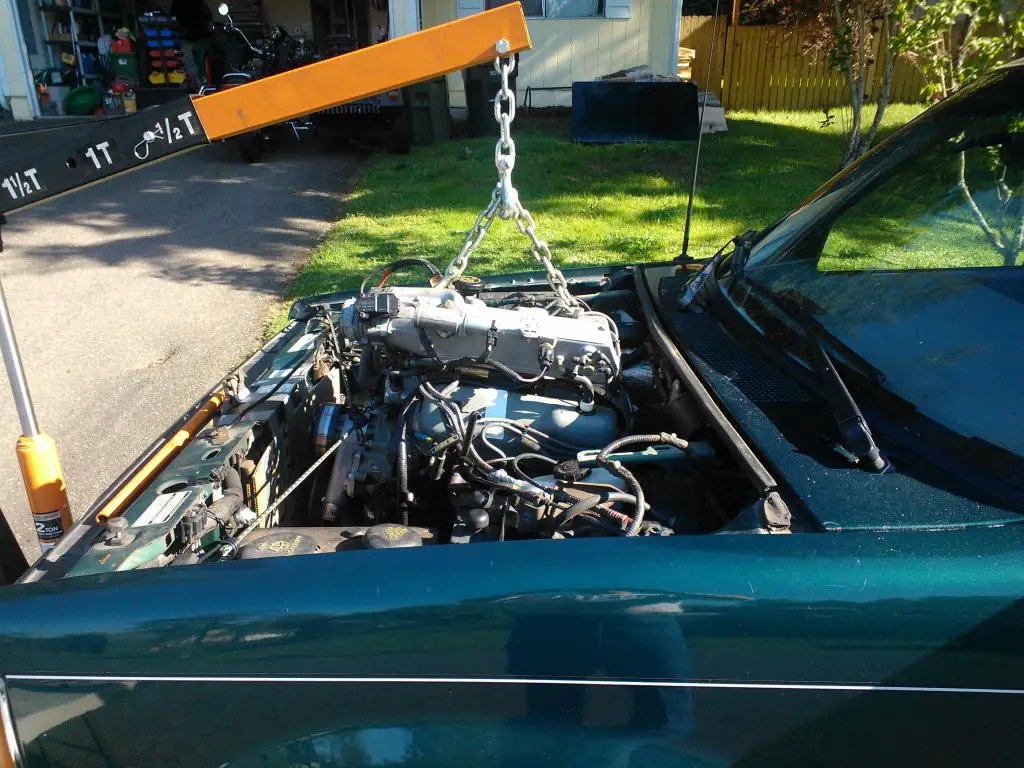

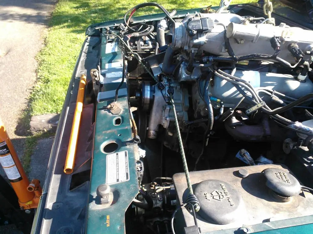

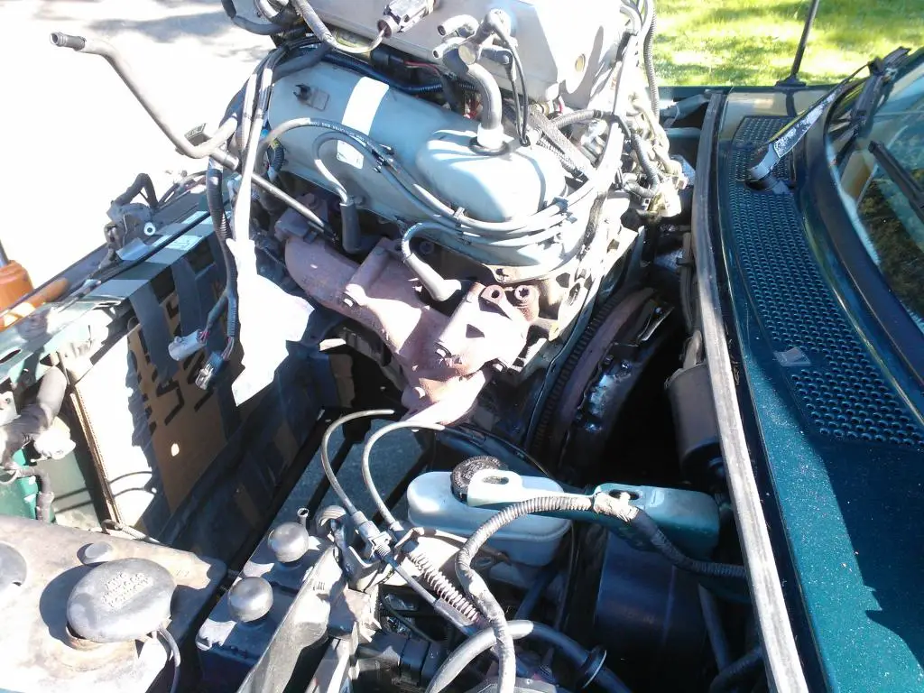

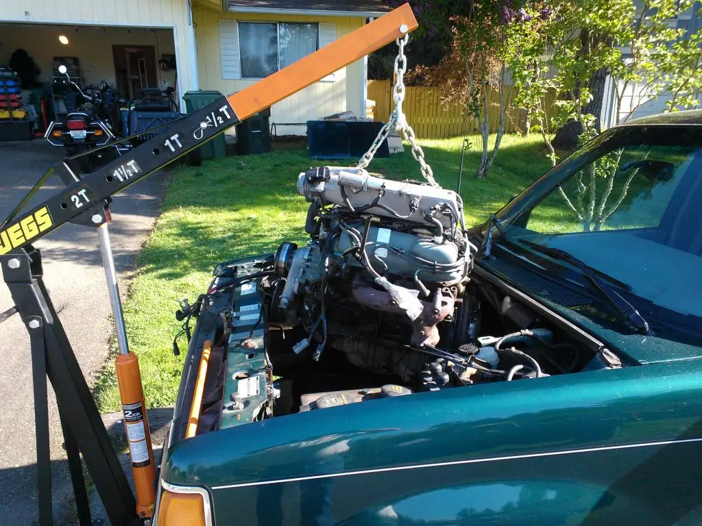

Getting ready to pull it.

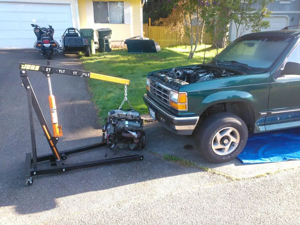

Gee, it comes out pretty easy when you take the top two bolts out.:fire:

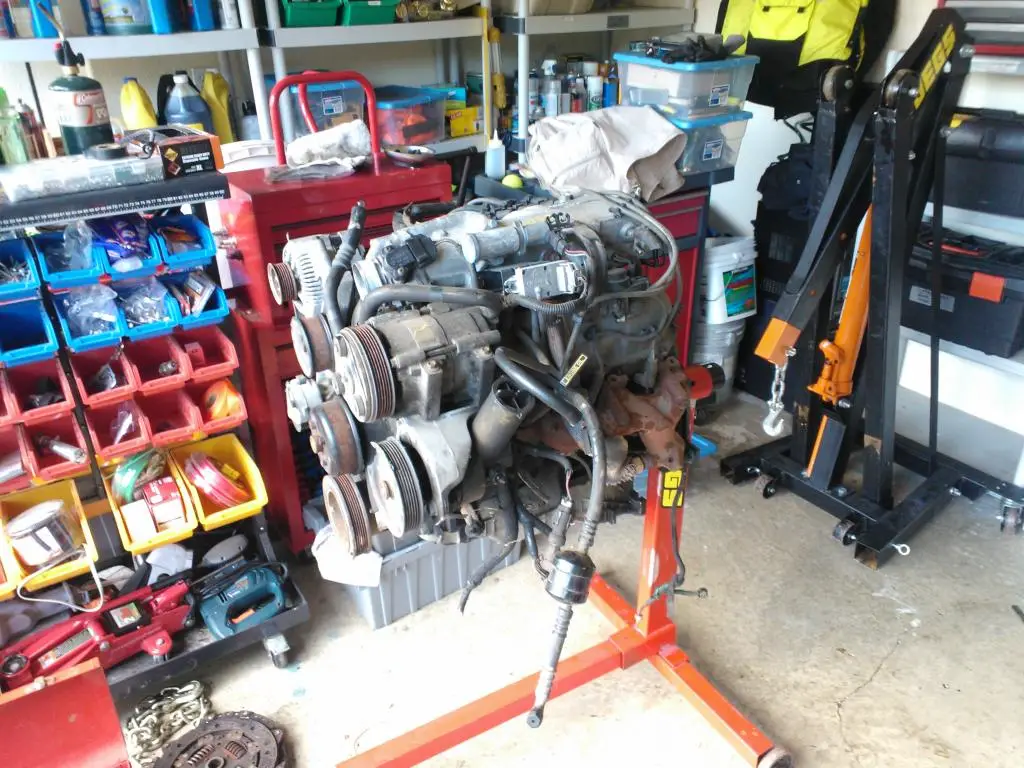

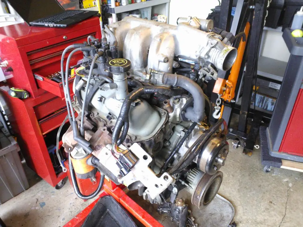

I'll post more pics of the engine, but here's a sample.

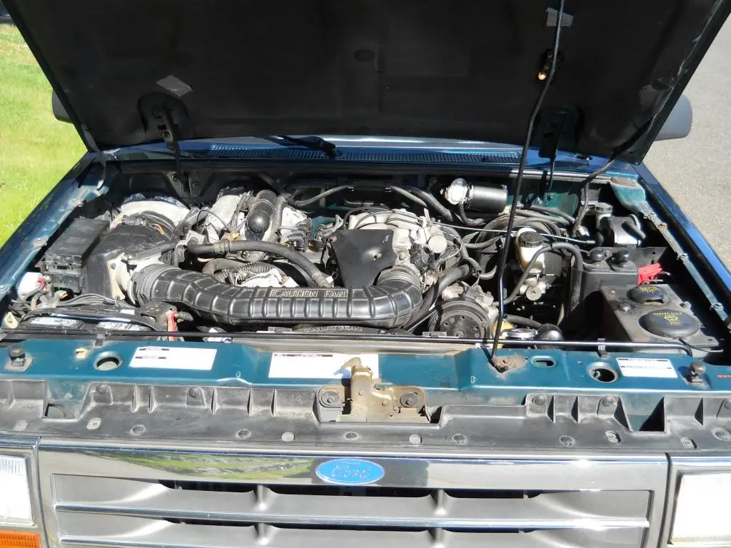

Here is the yard engine ready to be stripped down. It has EGR stuff; mine didn't. I was pleased that it came with the alternator and compressor. Looks like it'd been sitting for quite a while.
Here it is ready to go in sans the clutch and pressure plate.
I picked up a jack from a buddy-beats not having to deal with the rental I used to pull the old one. Though the rental was a beast, at least I had plenty of clearance. I could have put the engine on the roof with it. This jack was a little tighter fit.
I took the day off to take advantage of the nice weather. Bad part was doing the job by myself. Lots of crawling under and out of the underside of the rig.
Finally in. Quite the challenge. This was pretty much how it looked at the end of "day one". The next day I mounted the brackets and extras.
