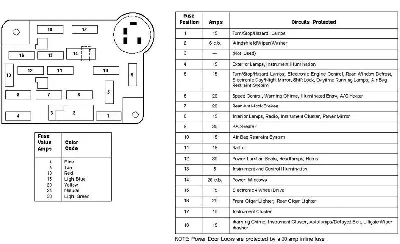

can anybody provide assistance with replacing 95 aerostar steering column, also need pic of under dash fuse cover so i can figure out which fuse is for air bag. thanks

Welcome to this forum! Here's a diagram of the steering column mounting bolts & nuts from my Ford software plus the fuse block:
