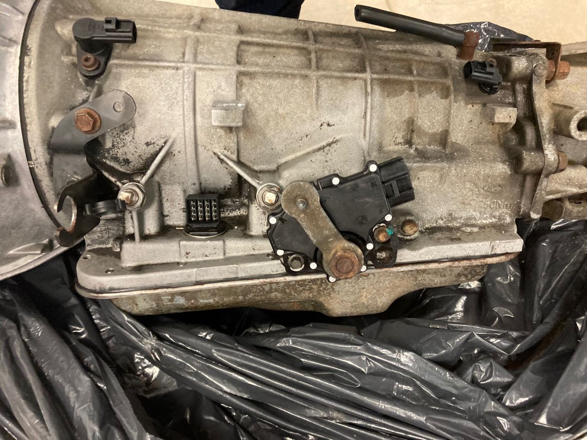

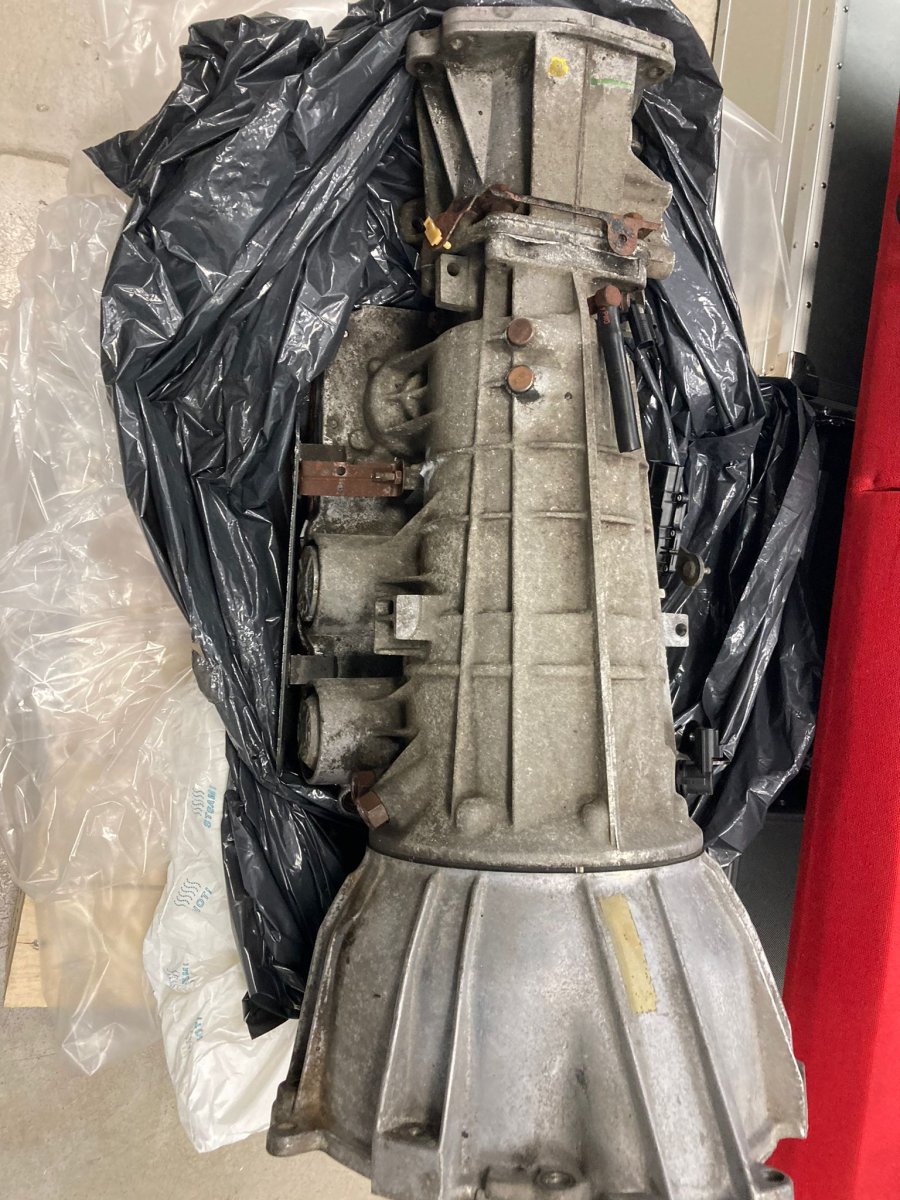

Digging up very old topic. Can you help me figure out, what transmission i have on Ford Explorer XL 1997, 4.0 V6 AWD
Sure thats a 4r55e or 5r55e auto trans from a 4.0 explorer 4wd
97 model year should be a 5r55e version
