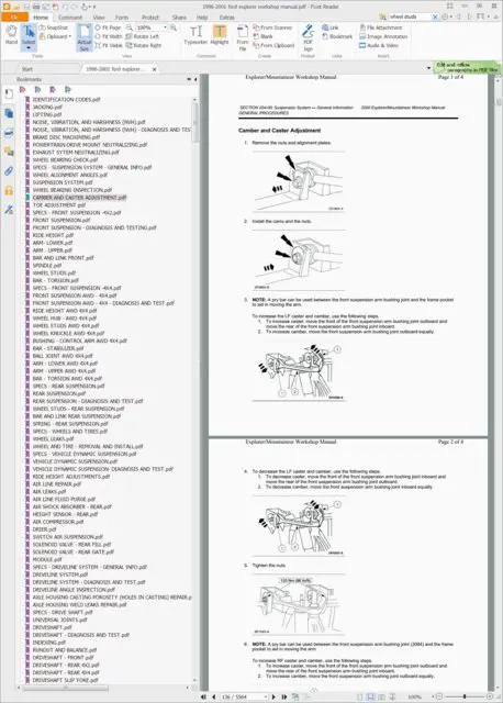

It's several individual PDF files joined together so no table of contents or index, and the embedded links are broken but being an electronic file that is less important... say you search for "ball joints", it'll find that. Being over 5,000 pages it does take a while to search but contrary to the initial warning it does not take long at all for it to load on Foxit Reader with my modest few-years-old system, needs about 160MB of memory to load. Might be too much for a phone to handle, then again phones these days are amazing...
Many thanks to you, and Hacra, for making this available! Much more useful than the Chilton manual I just got.
