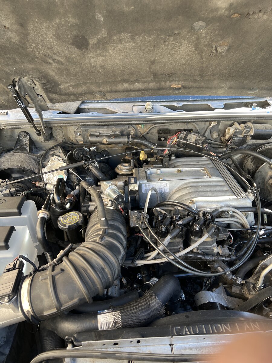

No pictures today. However i did get more detail work done. I installed fiberglass heat shield boots on the ends of the plug wires. Routed the plug wires pretty nice after that. Finished installed the Power Steering pressure hose. Had to transfer the hold down bracket that on the hose that attaches to the AC compressor stud. Installed the Wiper/coolant tank. Installed the Cruise control unit.
At this point the list of what is left is as follows. Attach AC condenser to the radiator. Install Radiator/condenser including the rad hoses. Attach AC hoses to the condenser. Install air cleaner box, and intake tube.. Fill with coolant. Install cooling fan and shroud. Need to replace the coolant temp sensor connector. And I need to repair/remake the small vacuum lines that go from the vacuum reservoir to the intake and to the purge valve. And I think the last thing is to drop the battery tray back in. I do think that's it.
Well the Holidays are always good, my sons are home from the Army and Navy for a little bit. But There is never enough time to get some things done. And now I'm on a deadline to finish this EX project. I'll update you all soon! This thing will drive before 2022!

Very close to start up.
That's one sweet engine compartment with all those new parts...

You sure did! Nano seconds!! Its running pretty smooth, though i think the IAC valve isnt perfect. If i rev it a bunch, it cant keep up so well and died a couple times. Also the new thermostat housing i installed has a plug on top where a sensor could go. Well i should have pulled that and put some teflon on the threads. Im getting a tiny leak there. So ill have to seal that up. Could be worse. Also need to vacuum the AC system and charge that up. As well now it needs more gas before I go for a spin.
Then time to button up the interior. Install a radio. And a nice set of tires.
Very nice, now it's time to button it up and drive it for a day or so. Give the engine a gentle spraying of a water hose, after some engine degreaser. That will clean it up and even it out well.
