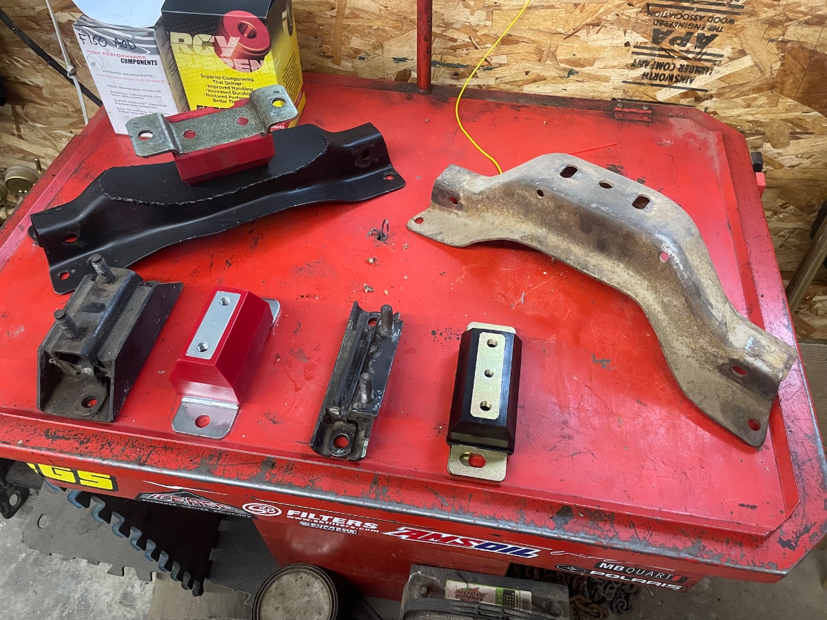

Here is what the crossmember looks like
Yes the side bracket stay in place they are welded to the frame. Those are the torsion bar hangers
