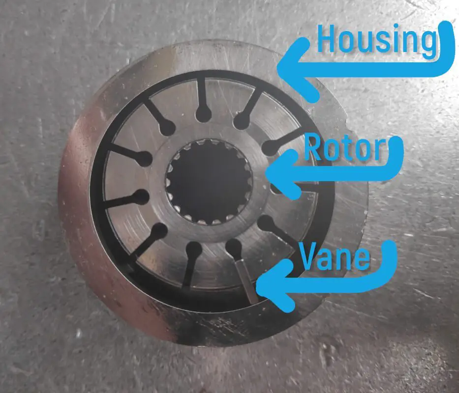

When running a newly rebuilt pump, you will get a certain amount of break in noise as internally the pump's high carbon based pressure vanes break-in.
It may take as long as a month or two and then it'll start to quiet down.
The reason is most (if not all) of the rebuilt pumps are rebuilt in Mexico.
The "refinish" machining on the inside of the pump that the high carbon steel based pressure vanes match up with is pretty rough - that's more than likely the noise you're hearing (the vanes scraping the rough surface).
It's loud enough that you can hear it with the engine running, and the hood closed, primarily when you turn the steering wheel left and right.
About 6 months ago I replaced my P/S pump that started leaking after 100,000 miles w/ a A/C Delco Professional P/S Pump.
It too was rebuilt in Mexico, and after installed and bled it was noisy enough that I got a couple of comments "what is that noise under your hood".
After about a month - all is quiet. The vanes eventually machine/match themselves up with the rough surface they are riding on.

Yeah - it used to be that as recently as the 90's P/S pumps were rebuilt in Motor City or the Great Lakes Region, then NAFTA killed that off and all it all went to Mexico...
Rebuilders in America would take the time to really clean up the finish on the inside pump, because it's the interface between that surface and the high carbon steel brushes/vanes that ensures high pressure and low noise.
Now that P/S Pumps (and starters and alternators) are rebuilt in Mexico - we've seen the quality fall far off, even in the name brands (i.e. A/C Delco Professional). We read about it all the time here in the forum - guys getting a "bad" rebuilt starter or rebuilt alternator right off the shelf. That's why guys like @donalds take the time to rebuild their own alternator ;)
In closing, I will say that the FORD P/S pump with the attached fluid reservoir (as used on the OHV model Ex's) is the same P/S Pump that was used on FOX Body Mustangs in the 80's. Anybody that's been around a FOX Body 5.0 knows the sound of the FORD P/S pump "growl" as you turn the steering wheel L to R and vice-versa. There's a certain amount of noise "built into" the design of this particular pump. That noise brings me back to a certain '85 and '86 GT and the mantra I used to live by; "Our Lady of Blessed Acceleration, don't fail us now" :cool:
