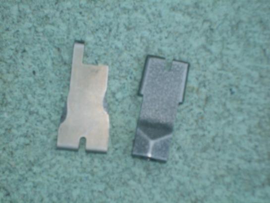

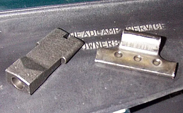

I was looking at the picture and you show a picture of a single wrap band lever (right) and a double wrap band lever (left). The 98 did not use a double wrap band. Where did those pictures come from?
He says that the Ford dealer handed him those parts which supposedly came from the pan.
Thanks for responding, I figured you would know what those are. ;)
The Ford dealer said both pieces came from pan when they drained it to investigate. They handed both to me when I checked out. Now to be clear I have a 98 4wd 4.0 sohc. Whats you thought about the two pieces.
I took the three sets pf pictures. They are of the same two parts just different views to enable ease of identifying.
I mis-spoke before. The bigger piece is where the adjusting bolt attached to the band and the other one is where the servo "flipper" actuates the band to effect the shift. Your 2-3 problem is because you do not have an intermediate band working Something (the band achors(s)) *likely* is broken (the only other way you could do that would be to over loosen the adjusting bolt and let them fall out).
The only way to replace a bad intermediate band is to remove the transmission and tear it down about half way. Once you get that far into it you may as well rebuild it.
Sorry for the bad news.
Since the dealership wants to replace the trans with a new (remanufactured) one, you might want to get some estimates from an independent transmission shop on rebuilding the one you have. Or you can do it yourself if you are adventurous.
