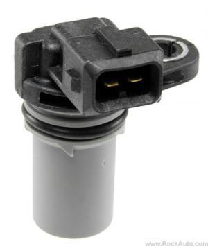

cam sensor
The camshaft position sensor on the SHC V6 is located on the driver side just aft of the oil filler tube.
It allows the PCM to determine whether cylinder 1 is on the compression stroke or the exhaust stroke.
The camshaft position sensor (synchronizer) on the OHV V6 is located at the top rear of the engine near the firewall. Are you sure your engine is the SOHC V6? The 8th digit in the VIN should be an "E"?

The CMP sensor is simple to test. I believe you want to check the harness for signal 1.5V then check the sensor while cranking with a meter, set on the AC setting, checking for voltage pulses.

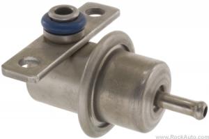

fuel pressure damper
Your 1999 has a returnless fuel system with a fuel pressure damper on the fuel rail.
It has a diaphragm in it that can rupture allowing fuel to get sucked into the intake manifold. I suggest you disconnect the vacuum hose from the fuel pressure damper. If fuel is present in the hose then replace the damper.

What was the result of checking the fuel rail damper?
It sounds like it is getting flooded with way too much fuel. What are the fuel trims? You might pull the battery cable for a few minutes to reset everything and see if there is any difference. Is there any restriction in the exhaust? It almost sounds like the spark timing is way off (but it did run for that short period).
fuel rail damper was dry. My buddy seems to think its the fuel pump/regulator. as in his words after consulting another mechanic the fuel psi is there but the fuel volume is not. He said by testing the fuel pressure again that when he presses the valve the fuel will not squirt out, very little actually comes out but the pressure is there. He said with his psi checker that the tube shows very little fuel in it when testing but the pressure is accurate. Any because it has been cranks so much, and prior to him getting it there has been too much fuel that has flooded the system. Now the oil smells like fuel and he suspects the intake is full of starter fluid now and yesterday a friend had the idea to put fuel in a cylinder to see if it will start, so we are just too flooded.

replacing the camshaft sensor
It is easier to replace the camshaft sensor than to replace the crankshaft sensor. It is mounted on the valve cover behind the oil fill tube. You just disconnect the electrical connector and the two mounting screws and lift out the sensor.
