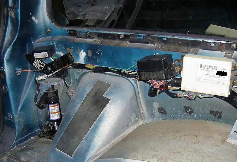

Check to see if it has rear air shocks, or the ARC switch in the jack compartment, above the jack in the corner? If so, that light may point to a fault with the ARC system, which is a rear leveling air shock system.
