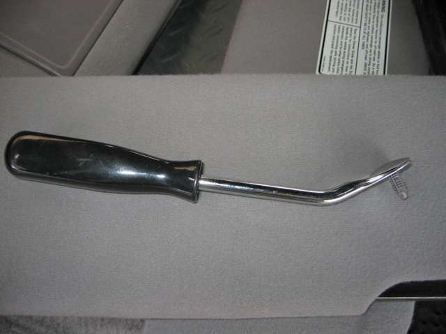

sorry to bump up such an old thread...I was just wondering how do you get that panel off? I kno there are a bunch of fasterners but i pulled on them and they wouldn't budge, I'd rather not break one off either. Once again sorry for old bump
I can't say for sure on a 98' but for mine, a 93', you just have to pull on them and they are a PIA.
The trim push pins can be a PITA - unless you have the tool below: This is a $5 item at AutoZone and makes quick work of removing them without damage. I used it to remove all the pins in my XLT when I repaired my headliner (without damaging a single one). I wish I had this years ago...
Cool! I'll go check that out I think i've seen one laying around my grandpa's place i'll see.
