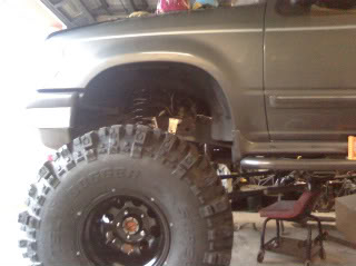

Well I got some parts in and started cleaning up the frame to mock up where everything is goning to go. But duty called and had to go to the J-O-B.
Radius arm extension and 6.5" lift coils
Gears, bushing, bearing and lots of goodies.
Quicky mock up.

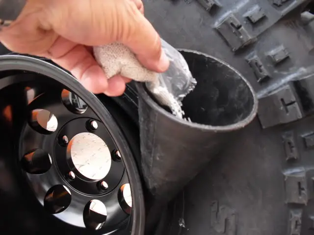

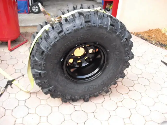

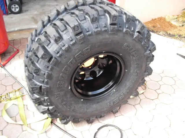

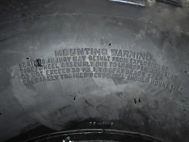

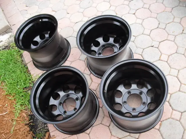

Well progress has been slow. I finally got my wheels back from the powder coater. Today I mounted the tires and I used dynamic beads to balance them. I have never used them before but from what I have heard from those that have, they should work well. The rear is set up so I will start working on the front soon. Enjoy the pic's.
Disclaimer:D

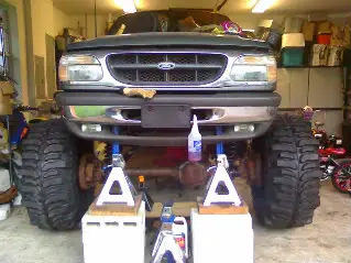

Well, Its been a while,but I got a little work done on the front end. Everthing seems to be lining up better than I thought. Hopefully I can get some more done this week. Wish me LUCK!
OH MY HOLY CRAP! this thing is going to be a BEAST!
