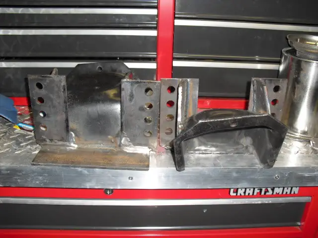

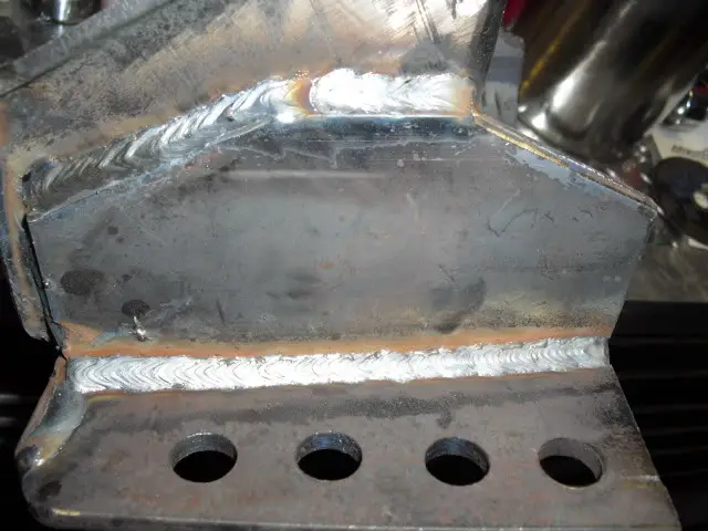

Well its been a while since my last post. I was able to mock up the spring buckets and modify them the way I wanted. It does'nt look like much, but its a step in the right direction. Check them out.
Well I was able to break away from "Honey Do List" and put some hours on the Ex. I got it standing on its own , Springs, buckets, and bases are in. Now I got to make a trac bar, mount the steering box and so on. Lets see how long that takes. At least I have not given up.

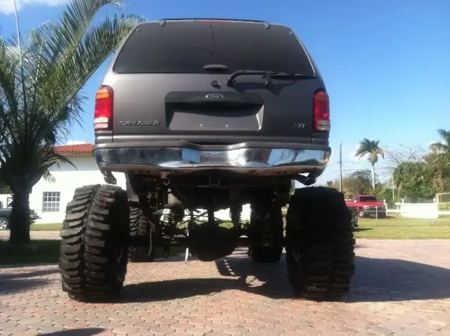

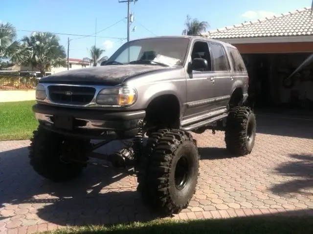

Here are some updated pics. I got some more work done to the monster this weekend and it came out of the cave on its own power. Still need to get the steering and a few things done to be complete. Enjoy the pics for now.
i know i am new here, but it seems like there is going to be a lot of leverage put on the radius arm where you extended it. it looks like there would be a decent chance that would bend or break if it is not reinforced. looks like a good project though!
