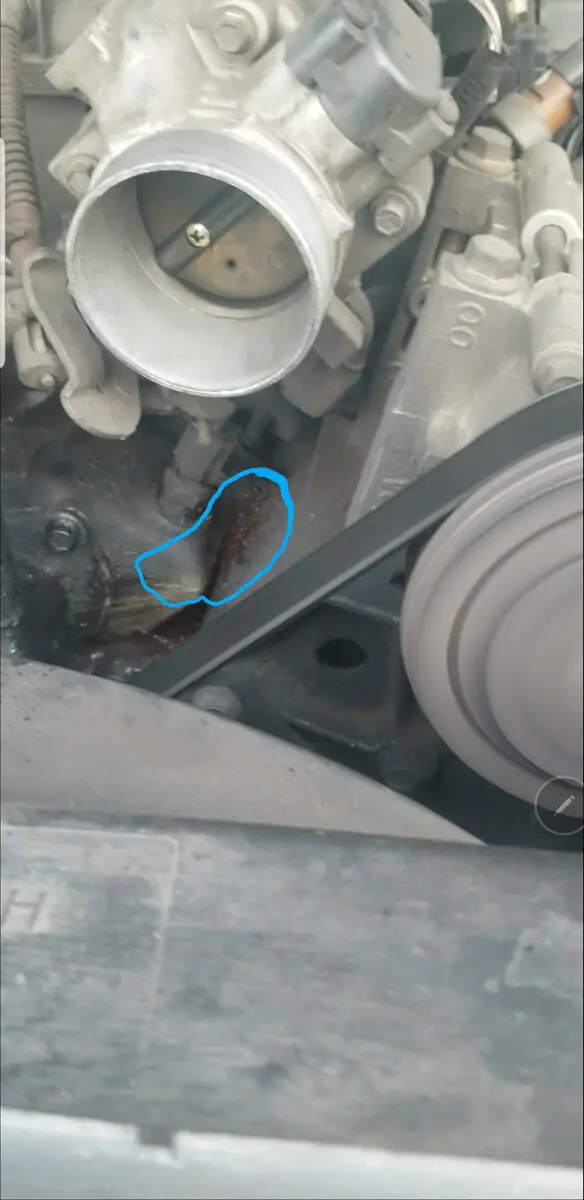

Is it part of the intake manifold on mine? I think it might have crack because water is leaking out there. I attached a pic of where it is leaking. Or is that a blown head gasket?
