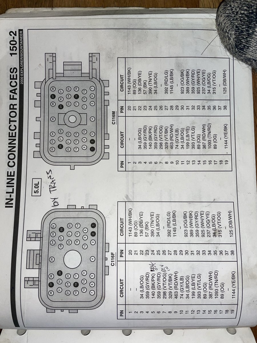

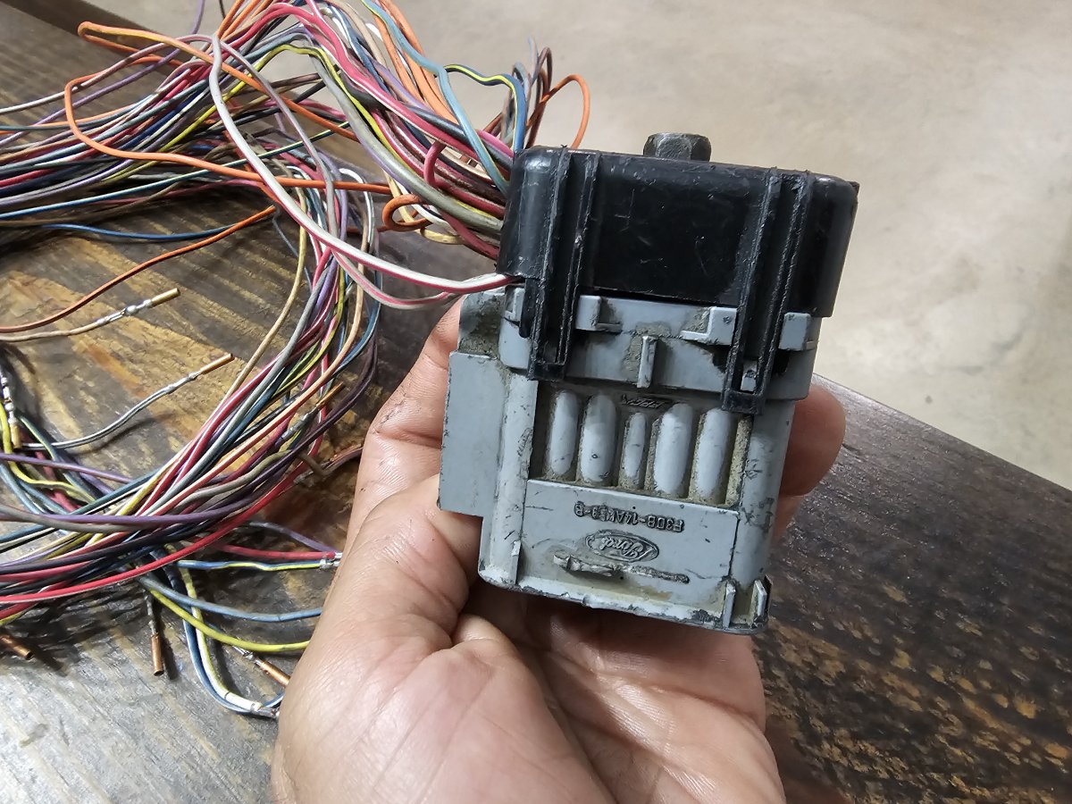

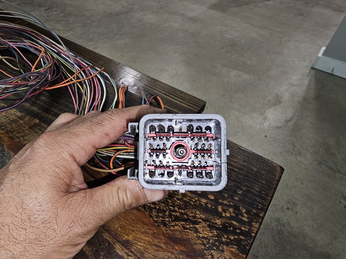

I am in need of the 38-pin connector (square one with the bolt through the center) harness breakdown from the side of the transmission. 5.0L v8 Explorer. Apparently, Mitchell doesn't like to provide that information anymore. Thanks in advance! Please see attached pic.
The plug is called c116 I’ll post the diagram for you
Thanks 410- if you do you have a description of the pin #'s. If the diagram has that it'll work as well. What service manual is that? I use Mitchell DIY but they apparently don't know we need connector views. Thanks for everything so far.
This is the factory wiring and vacuum diagram book you can get them on eBay for under $40
The PIN numbers are listed as are the circuits and colors
If you are looking for a list of the wire circuits and their functions I do not have that handy
Most of them go from pcm to trans or 02 sensors, then a couple for the start circuit
