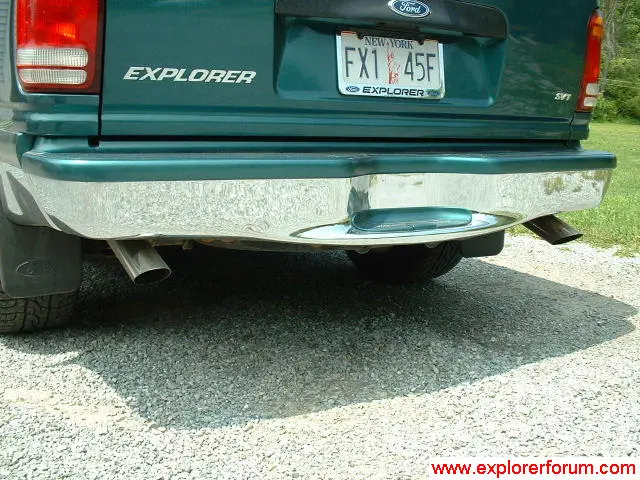

I was told the same thing once for my '93 EB. It is possible to run the dual exhaust though. You can extend your lines and tuck them up and out of the way. Are you thinking of getting the complete Flowmaster catback system? I'm just waiting on my tax refund to roll in and I'm getting the Flowmaster 50 series exiting the side, but having it split to look like the Gibson dual sport.
taho1.html
But have that tucked in more so it's not so exposed and tacky. For a single side exit it should be much less than $300. I'm about to call and get some quotes too. I'll let you know what they tell me.
