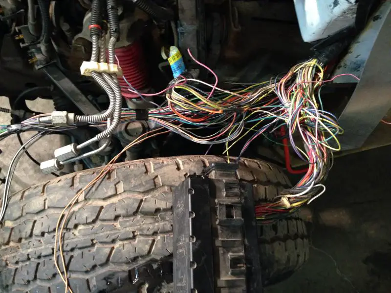

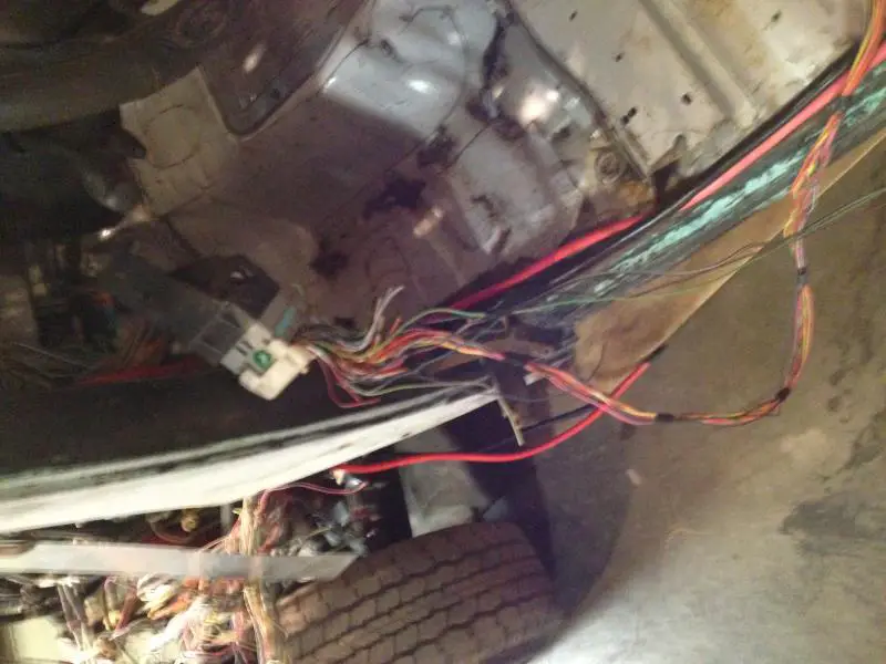

So a few years back I helped build a 1949 Ford F1 truck body onto a 97 5.0 AWD explorer
The F1 only needed the very basics from the explorer.
I started at the front bumper and removed every single wire, relay, fuse, anything that was not needed and I mean anything. At the end of the day we ended up with a 97 power distribution box with like 4 fuses and 3 relays in it, everything else was removed. There were only two other small relay boxes that remained as well. All behind the dash wiring, cab wiring and everything under the truck was all stripped out. Only circuits left were lights, the instrument cluster and what was needed to make it run.

see all those cut wires? later I came back and removed every un needed pin
more circuits being removed one by one

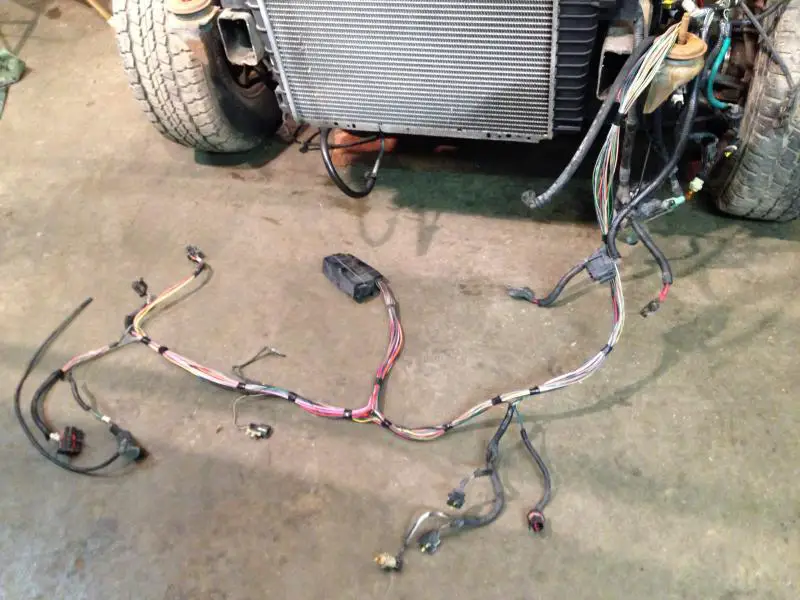

before
after
this is the completed truck side harness
