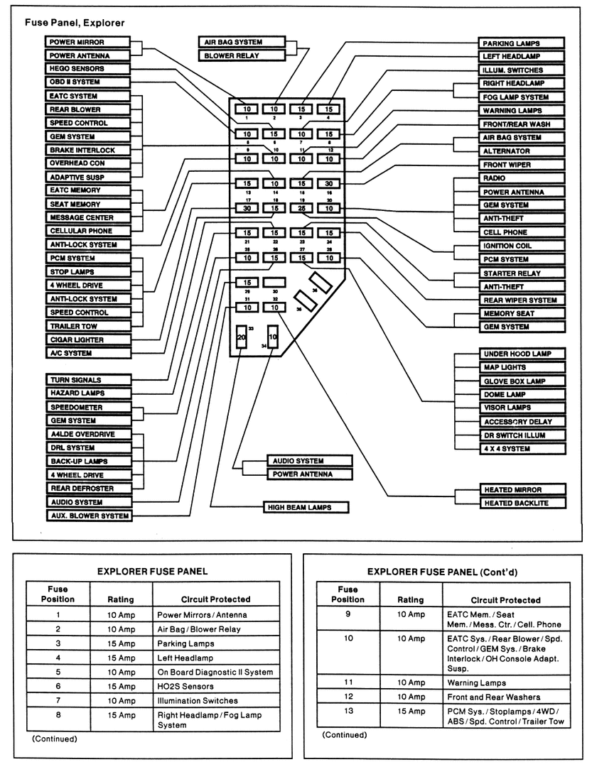

Welcome to the forum,
The stock radio does in fact have a fuse, but it's in the fuse panel, not on the radio itself.
Sounds to me like that's blown.
Check the fuses for Audio System and Radio.
Oh yes, I have been there and replaced that. I have every fuse in the truck up, I can't honestly say the same thing about the switches or whatever they are called because I have no idea how to test them.
EDIT: i tested the fuses again because why not right? and my tester said they were good. But at this point I felt almost compelled to look at them. so I took out 29, low and behold it was broke, put it in tested it again, still said it was a good fuse. Needless to say I threw the tester device I had out and I feel like an idiot for not doing what I knew I should have done to start with. Now if only I could figure out how to control my amp/subs from my radio. Thank you DjDom! I are retard.
