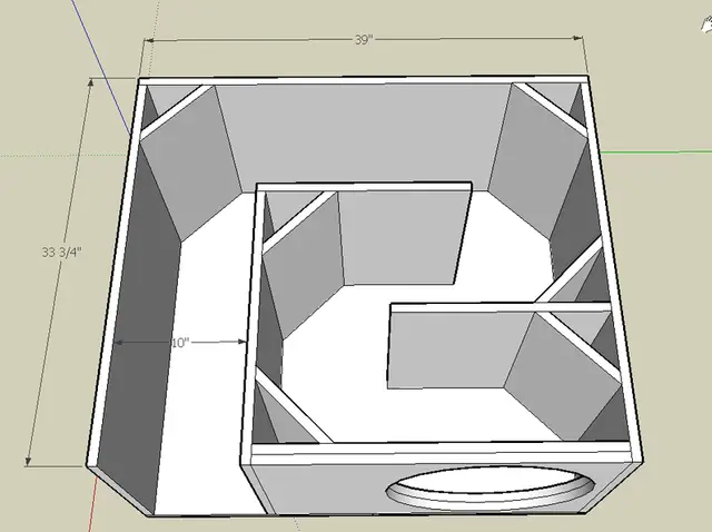

In the back of my explorer...looky
Mmmmm....T-line. Me likey. What 12 are you using in there?
