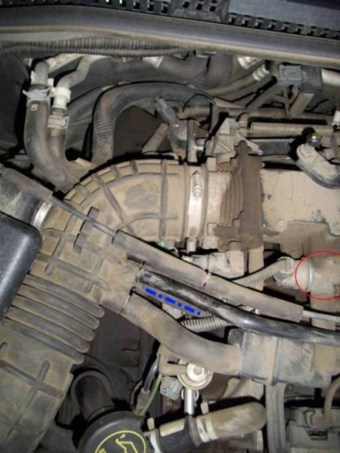

read the thread and it sounds exactly like my issue, but I cannot figure out which hose it... I have attached some pics, if you could PLEASE point me to which to check that would be AWESOME!
If your engine is similar to mine (and I think it is) then find the PCV valve located on the passenger side valve cover. Then follow the hose the PCV valve is connected to. In this picture you will see the hose assembly I'm talking about. On the left side of the hose assembly the PCV valve would plug in. Obviously on the right side you can see the elbow.

Now referring to one of your pics:
I believe the red circle shows your IAC. The blue dotted line may be the hose assembly I have been referring to. I say "may" because I can't quite see everything I need to see in the pic. The pics you took are less than ideal for purposes of trying to find the PCV hose line.
Thanks for the help, I was able to locate it and sadly it was fine.
