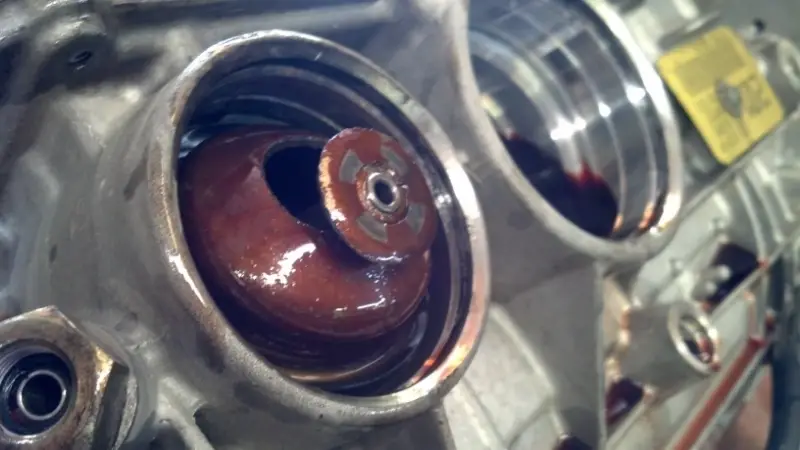

03 Mountaineer 4.6 should be the 5R55W they changed to the "S" in 04 according to my info.
The p0775 code sometimes can be a broken OD servo, problem with the quick fix is that it tends to burn the band. If the servo is broke I would replace it and drive it till the band lets go completely.
Thanks for the info and photo!
However, if I find a 5R55S instead of a 5R55W, is it compatible? Would I be better off replacign with a 5R55W, or S?
