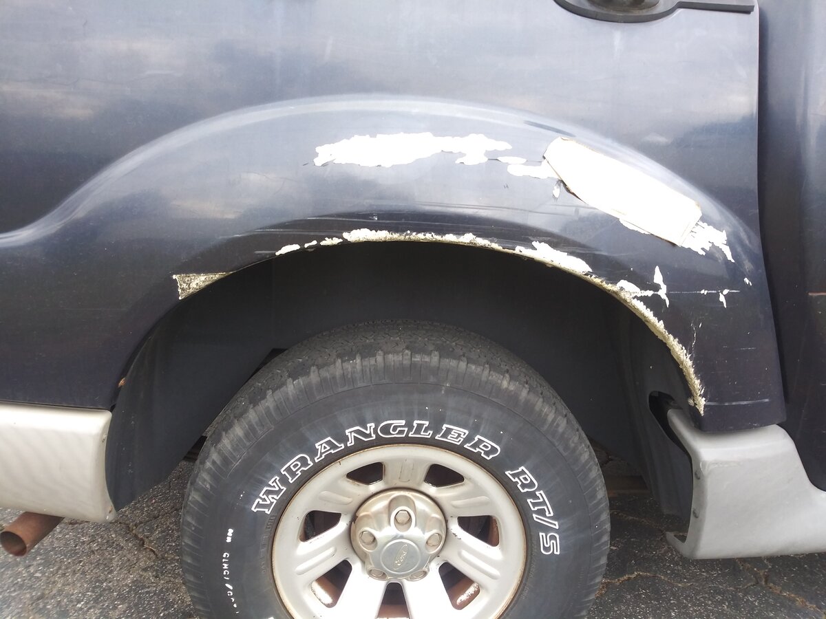

Oh, nooooooo! To change out the right rear quarter panel, the bed has to be removed?!?! Yikes. That is what I was afraid of. I found a replacement in my local U-Pull-It for ~ $115. (I need to replace the right rear quarter panel of my 2001 Sport Trac.) UGH!

To remove just one side, you have to unbolt the bed in order to access the vertical row of bolts that attach the side to the front. There's a row of bolts along the upper inside of the box as well. Probably more too - inner wheelwell liner, etc. Once everything is unbolted, the side of the bed supposedly peels - and I do mean peels - off the under structure. I've never done it, and don't remember where I saw this info. It's possible, but is involved. Swapping the entire bed is much more straightforward and not too bad. The bed is surprisingly light, too, especially without the tailgate, which is almost as heavy as the rest of the bed. If you remove the tailgate, the box is front heavy.
I was able to get mine off with just taking the bed bolts out and moving it back a little bit to get to the front torx bolts. The big problem can be rusted bolts. Take your time and good luck.
