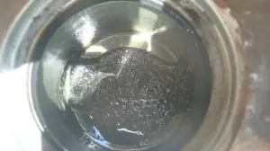

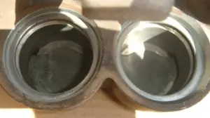

Perfect! If it's been over two years, probably a good time for a brake flush. I used one full quart of Valvoline Dot 3/4 synthetic fluid, about $10. After seeing the contaminants that remain in the bottom of the piston bore, I always open bleeders when compressing the pistons to replace pads. This is what I found when I opened my front caliper. (Left pic)
