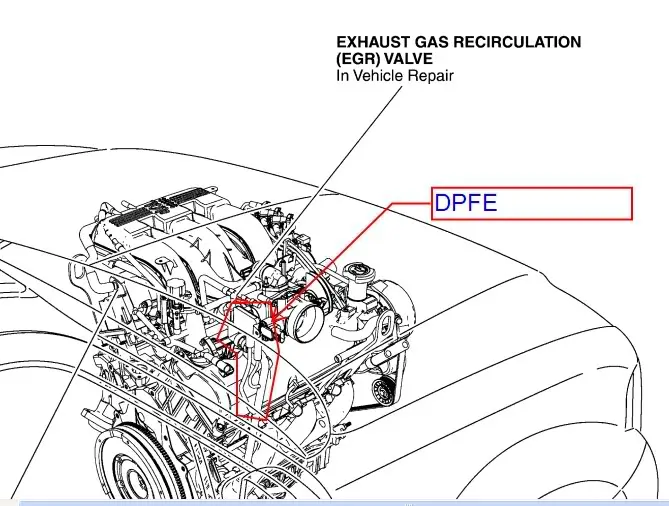

Easy can you be more specific?
I don't see one, all I see is a box on top of the EGR valve itself.
At the top rear of the engine. For the 4.0l it's more toward the passenger side. For the 4.6l it's more on the driver's side. This is from the 2003 WSM:
Looks pretty much like this except may not have the bracket on it:
http://www.explorerforum.com/forums/showpost.php?p=1381676&postcount=6
Don't buy aftermarket, get a Ford Motorcraft part. Silverstatefordparts.com sold one to me last year for $51.45 shipped.
That's were my EGR valve is. I donr see a DPFE there at all.
When I go to Rock Auto.com, 04+ dosen't have a listing for a DPFE. Same with Silver State

I think you figured it out. Lol. I was just typing a new message to say that they might have integrated it into the EGR on the drive by wire setups. That's too bad as it looks more expensive to change now. Let us know if you replace it.
