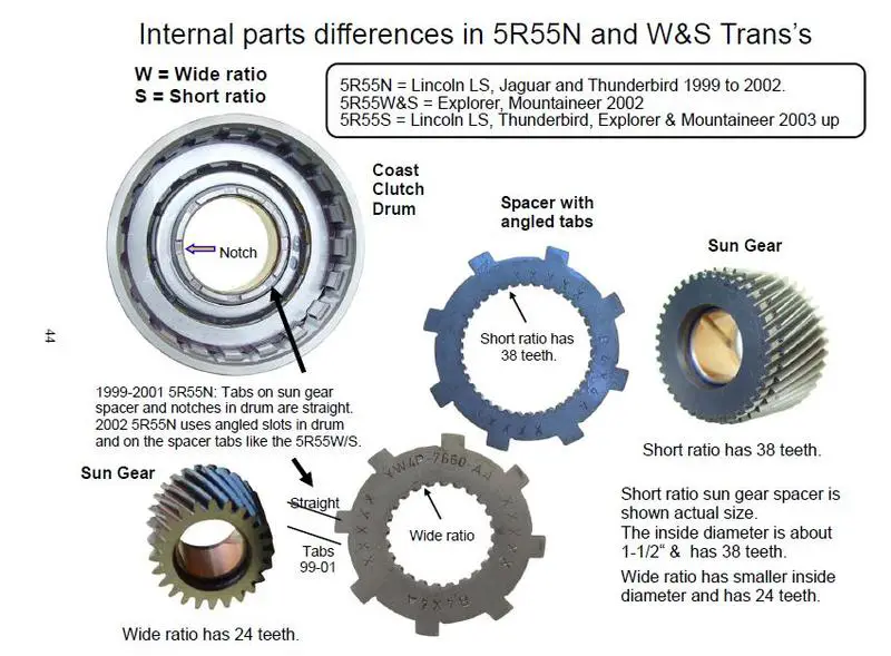

After several failed attempts to get this transmission to work I opted for a removal to disassemble. An inspection of the parts revealed that the sun gear is shot, the gear teeth are all but gone. I know I can count the teeth on the gear to find out whether it is a 24 tooth or 38 tooth system. But, I did not buy this car new so I don't know that a previous owner didn't change the sun gear assembly at some point. My question is, is there another way to determine which is the correct size sun gear that should be in my Mountaineer or does it matter since I have to change the entire gear assembly anyway? Will there be electronic reading issues if I put in the wrong gear?
Here you go, you should be able to figure out what ratio you have.
