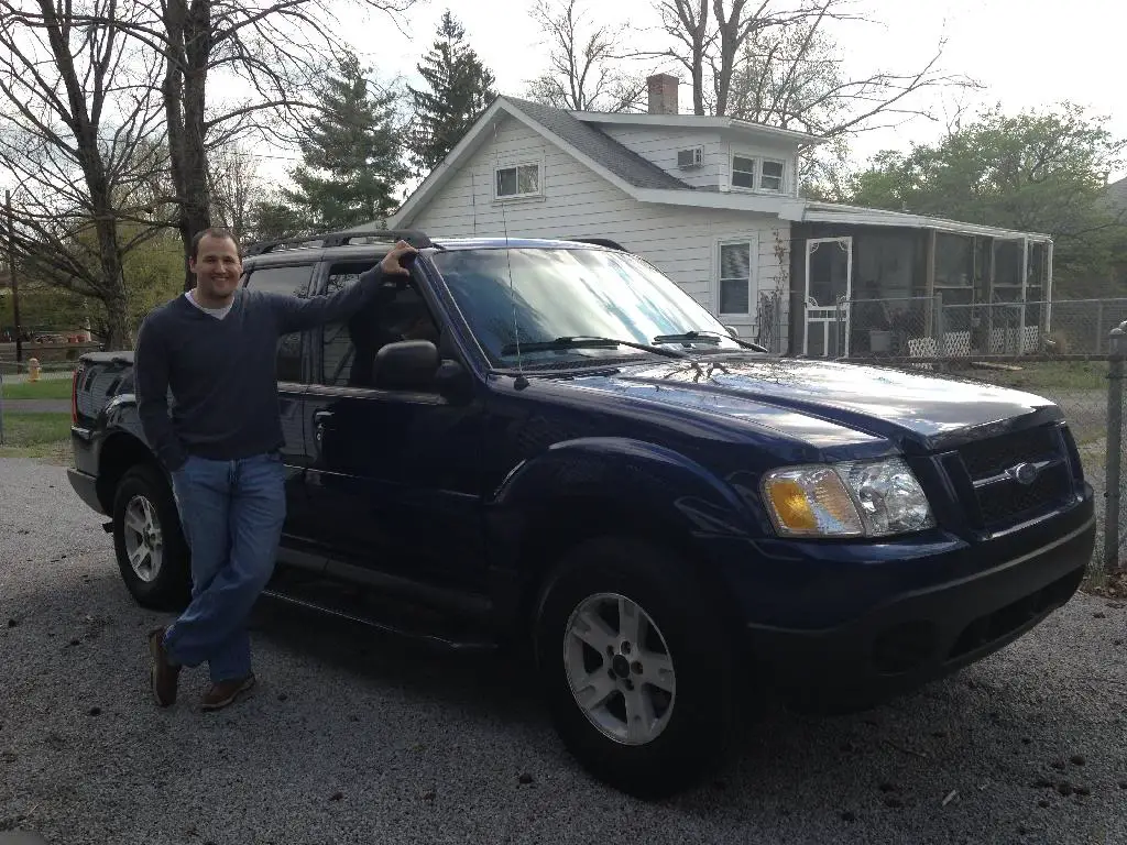

and here is a starting pic of her first time in the driveway.

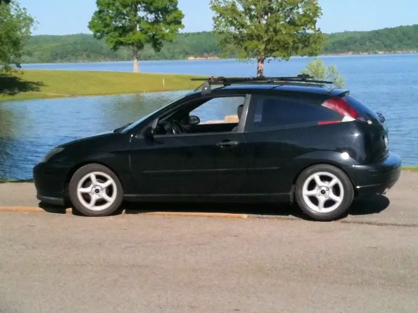

And here is my old car 2001 Ford Focus ZX3
