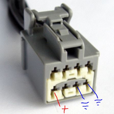

You should check for power and ground at the shift lock solenoid, if its getting power and the ground is good the problem should be in the solenoid. If no power then I would supply power to see if the lock works and the same with the ground, by now you should have a better idea on where the problems is and what needs to be done.
