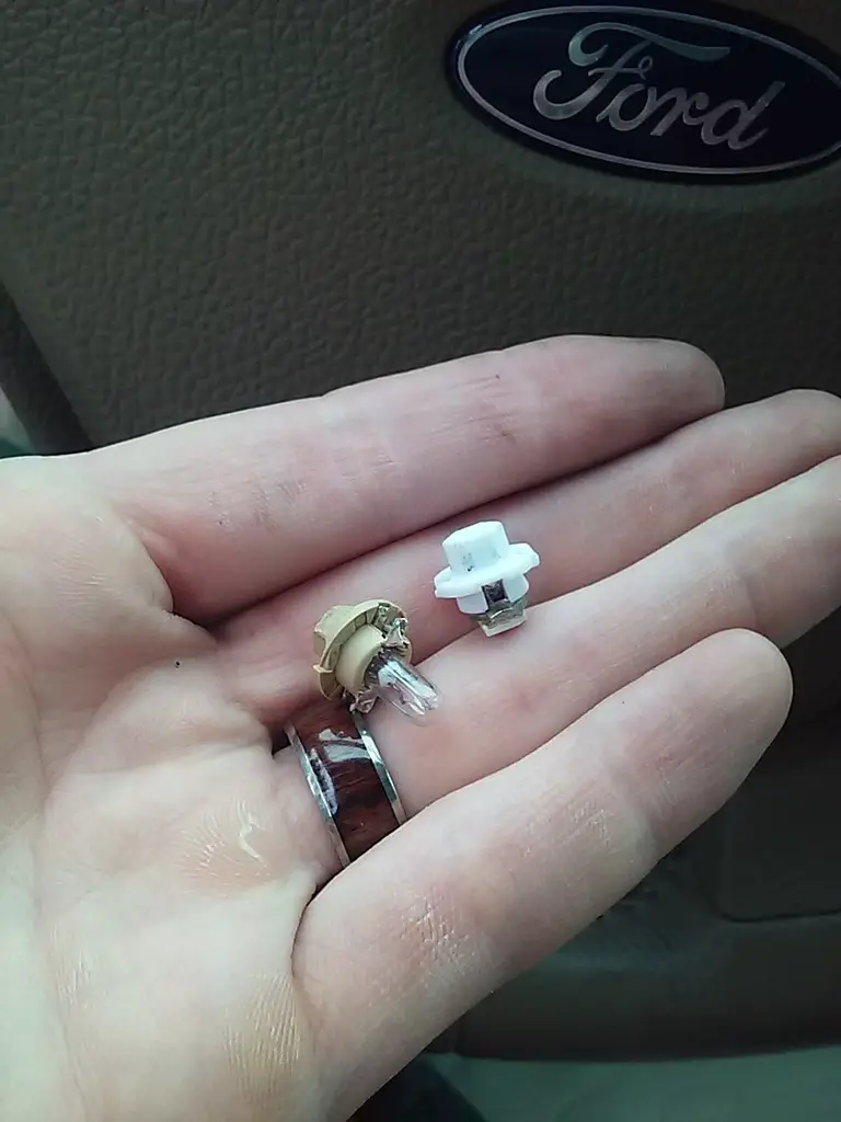

I just performed this job yesterday on my 2007 Explorer. I ordered some replacement LED's after finding that the OEM incandescent bulbs cost nearly $11 each.
The part I ordered was from superbrightled's, the product number is B8.4D, I got the white color. There are a total of I think 5 replaceable bulb sockets on the rear of the dash panel.
The removal/dissassembly is really very easy, and I'm certain you can get it done yourself with a little effort. Just twist the old bulbs about 1/2 turn and pull to remove. My existing bulbs had gotten a little gummy/soft in the heat, so I used a pair of needle-nosed pliers to turn them. I've heard from other forum members to not unplug that dash cluster though or it may cause a no-start condition, but I was able to complete the job without the need to unplug. I took some pictures along the way and a before-and-after as well, I'll post them when I get home to illustrate it for you all.
As far as the gear shift assembly. . . Mine is out as well, however I am not sure if that bulb is replaceable or not. Last I checked it looked like it was soldered into the assembly, so it may be a little more involved than the dash light replacement.

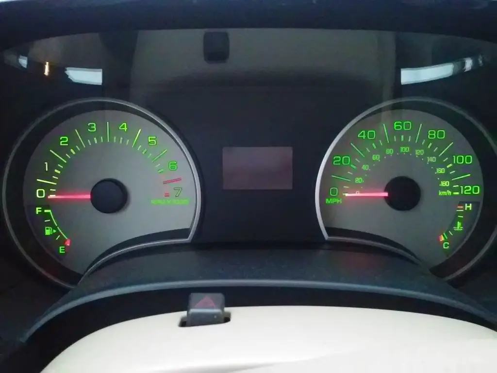

Anyways, I think the new bulbs are a vast improvement over the stock. I can finally tell how fast I'm going at night!

my apologies, that last photo does not show all 5 bulb sockets. There is one more where the coolant temp. Gauge is.
Are the LEDs brighter than the incandescent? Do they dim ok with the rest of the interior lights? I don't have any dead bulbs, but around dusk it is hard to see my instruments.
They are a brighter than stock as far as I can tell. They dwarf the other bulbs in my interior at night. And yes they do dim like the stock bulbs. Be sure to bend the tabs back a little towards the back of the bulb when inserting them so they fit snug. You'll know when you've got it right.
