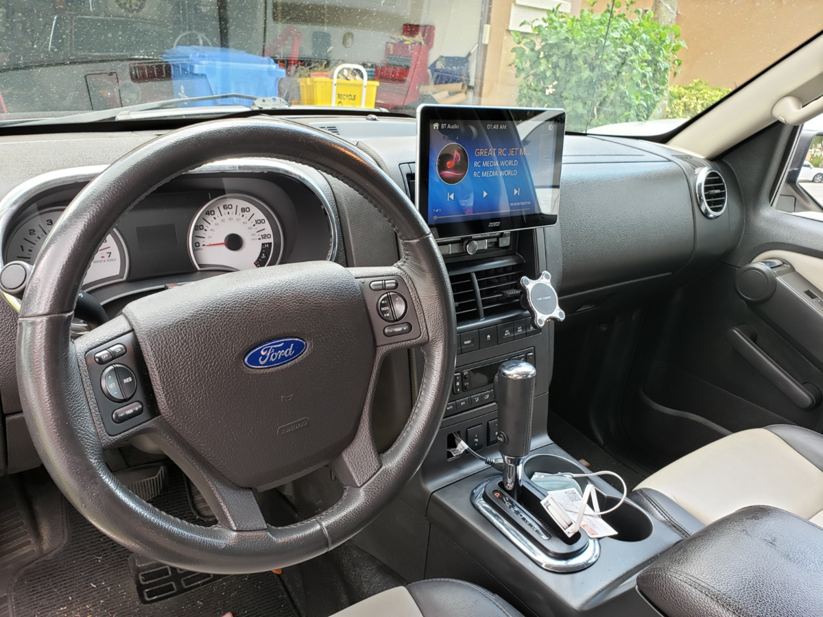

We put a Sony XAV-AX1000 6.2" with carplay and SXM
We got a TEBPC back up camera too
It came with a remote.
We had it installed by a local company called Creative Car Audio, Installed with tax, it cost us $326.99 As I recall, the stereo was on sale.
It's in my wife's 2008 Sport Trac Limited. It works as well as the back up camera's in our 2 F-150's. VERY CLEAR.
