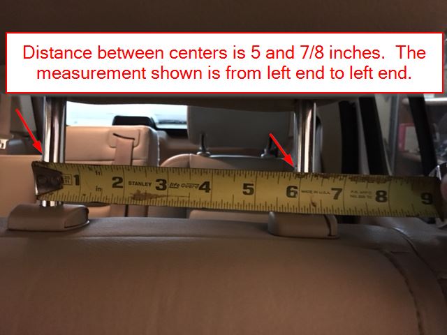

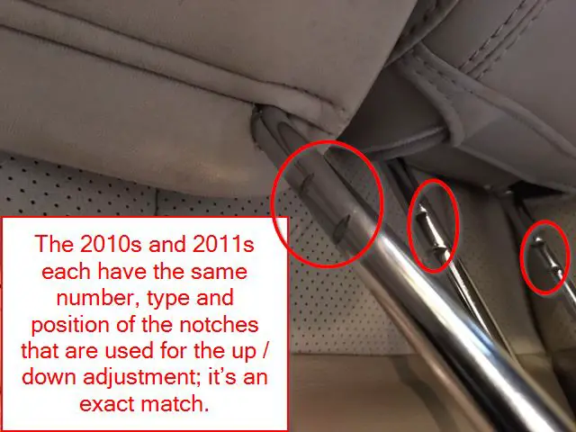

So seems like these 2011 adjustable tilt type rests – if they fit – would be a good solution. Lots of scouring the web and did not find a definitive answer about fitment. Emailed some folks selling “Fits 2011” for rod spacing and diameter and got varying answers on the spacing. The diameter for both the 2010 and 2011 is ½ inch but when it came to having someone measure the spacing on a removed headrest, I guess the rods have some flex, thus got different answers.
So I did a risk buy for a 2011 set and they fit! Ok how about the rest of the story? Are they more comfortable? Here is what I found out:

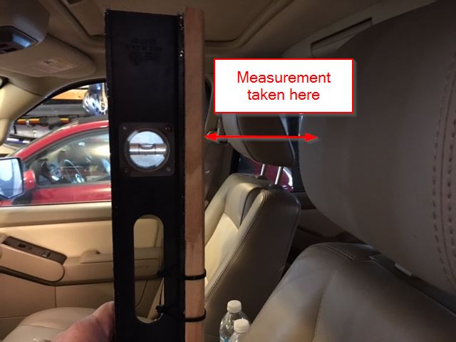

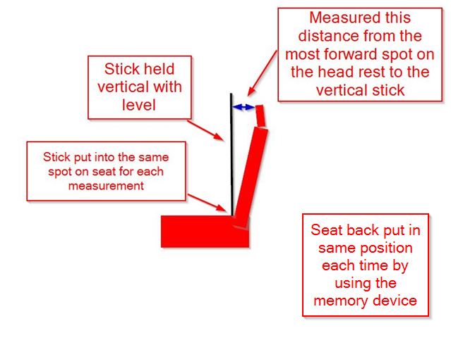

So came up with a way to measure the ‘forward push’. Attached a level to a stick and with the seatback in the same position each time (by using the memory / preset function), measured the distance between the vertical stick and headrest.
The measurements came out as follows
2010 Original 4 ½ Inches
2011 Tilting Style 4 ¾ inches
No wonder it did not seem to be a significant difference. So while I have reclined my normal seat position slightly, the back of my head always seems to be touching the (2011) headrest. Not uncomfortable like the 2010s but annoying. And if I recline the seat more to get a little space back there, it is too reclined for my liking.

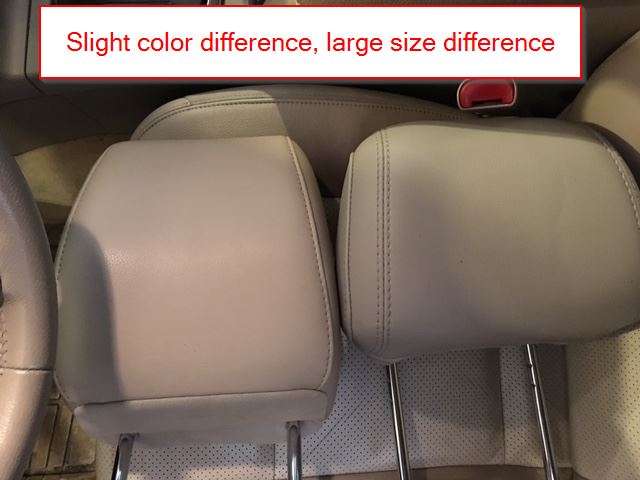

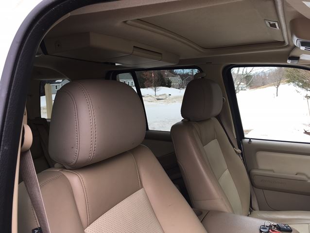

The sheer size of the 2010 rests make them unattractive in my opinion. I do prefer the 2011s for their smaller size. And as you can see in the pics the 11’s are a slightly different color (2010 is “Camel” and the 2011s are “Stone”). Even my wife did not notice the difference for the last few weeks they have been installed until I pointed it out the other day.
