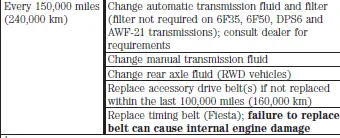

Did you get the Owner's Manual with the vehicle?

My transmission had 300000 miles of neglect, but I cant blame a previous owner. This was all on me
I followed the owners manual and had the transmission serviced at 150000 miles and again at 300000 miles. I thought I was getting a complete fluid change, but no; Each time all they did was a drain and fill (about 4 qts) Thats when I started to do some reading. Realized I might be in trouble. I sent a sample to a lab and then every 10000 miles I did another drain and fill and sent samples to the lab
each lab report showed the wear metals decreasing and the last sample, at (350000 miles) the oil was actually red. The car is now at 375000 miles and Im planning another drain and fill at 380000 miles

This is a good point to make. It take two back to back fluid drains and refills to exchange about 70%-75% of the old fluid with new.
