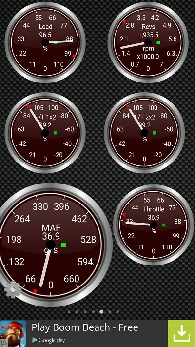

After reconnecting everything I started the car and drove it up and down a 55mph highway. It was rough idling and would constantly ping (lean detonation) at moderate loads or higher. I ran the TORC app, but I don't have any idea what the Mass Air Flow sensor should be reading versus volumetric load and throttle position. It appeared that the MAF was reading low numbers to me, but it was varying with throttle and load. In short, it sounds like I do in fact have an air leak somewhere past the MAF.
Can anyone look at my TORC screen shot and tell me if the 36.9 MAF reading is typical for a steep hill at 20mph and 35% throttle at 90% load? It pinged like crazy when I was at 70 load, 36 throttle, and close to 40 MAF reading.

Check for black gook in the MAF sensor (the part inside the air intake) especially if you have an aftermarket air filter that uses oil (K&N for example).
A shot of WD40 on the sensors will take care of it. DON'T USE carb cleaner.
If your MAF is reading low that may be the reason why its running lean.
CRC MAF Cleaner works well, I used it on my Duramax and haven't had any problems.
I wouldn't use anything else since MAF's are very sensitive, you can pick it up at any Auto parts store or amazon.
I'm not a big fan of K&N Filters or any oiled drop in replacements, the factory filter may be a little more restrictive but its a dry filter to not contaminate the MAF sensor.

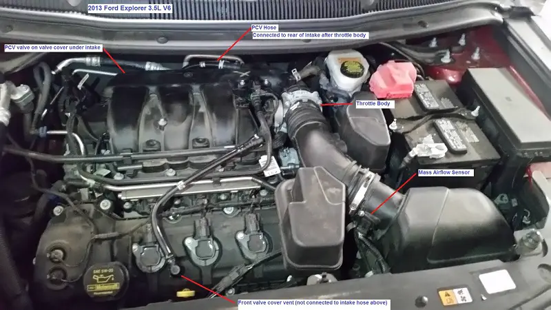

The PCV valve is actually under the intake and hard to get to on the rear valve cover. The hose from the intake tube to the front valve cover appears to just be a straight vent with no valve--maybe a baffle on the cover. The PCV hose connects directly to the intake on the back. I used my cell phone camera to take pictures of it all and assist in removing and replacing the PCV valve.
When I first found and removed the PCV valve and tube, it was quite full of oil, and it appeared a decent amount had been pulled into the intake and fouled the cylinders and all that jazz. I sea foamed the gas tank as well as one of their "spray for five minutes in the intake while high idling" treatments. That and premium gas for a few tanks seems to have eliminated all the pinging and check engine lights. The car is running fine now.
As you can imagine, spraying ether around the intake hoses and cleaning the MAF did nothing. I suppose I am fortunate I didn't overfill more and hydrolock a cylinder or two. The car first stumbled and died when my wife was accelerating up a steep hill fast. That makes sense due to the PCV being on the rear head, oil sucked into intake, etc. Be careful when pouring oil out of 5 quart motorcraft jugs.
