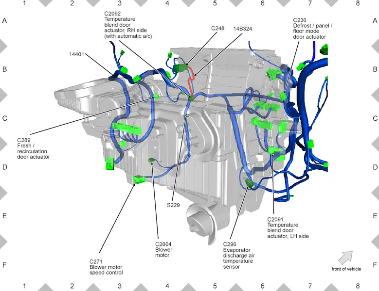

how is the air coming from the driver's vents? You could have an issue with the 'Blend Door Actuator' and there is a thread and TSB on that.

I have a 2013 Ford Explorer XLT dual climate control when heat is on the vent mode Heat blowing out the drive side and AC on the passenger side
2013 Ford Explorer XLT when heat is on it blows heat on driver side and cold on passenger side
Welcome to the Forum. :wave:
That is usually an indication of an issue with the blend door or blend door actuator on the passenger side.
