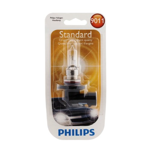

My sense is that since these "New" Philips 9011/HIR1 bulbs came in "Standard" Philips orange packaging, they are nothing more than standard halogen 9005 bulbs on a 9011 base.
The stock bulbs are just regular Sylvania halogens. I just swapped one 9011 into the right socket and drove to a dark wall and I really couldn't tell any difference left to right. I might even have chosen the stock bulb as being marginally better.
Yikes, if that's the case I'd be pretty mad at paying ~$50 for a set of regular bulbs that cost $10 anywhere else and demanding a refund or at least an exchange for the Philips Xtreme bulbs.
It'd be against the law for Candlepower to sell a regular 9011 halogen bulb as an 9011 HIR bulb, so while their 'disclaimer' about the coating is nice, they're still listing them as HIR bulbs when they're just regular 'ol standard halogens if that's the exact package they come in, and selling them at a deceptive price.
I feel bad about even suggesting the HIRs now, which got you to this point, you would have been better off getting some Sylvania XtraVisions or the Philips X-treme.
No worries. Again the 9005 in a 9011 base is just my guess. If they were really supposed to be 200% brighter though, I don't see Philips putting them in "Standard" orange packaging.
Weird thing is there's all kinds of interweb posts saying these things are great... maybe the Explorer is lamp housing limited, but I'm skeptical.

If the base says they are HIR1 and 9011, that's about all there is. I was suspicious that like you said, there was just a 9005 bulb on a 9011 base, but that's either the case with certain bulbs, or, possibly more likely, the Explorer halogen headlamp can't do anything with the additional output. I guess the Philips X-treme bulbs would be the second test to determine if that's the case or not.

I got them from a reputable ebay seller before I found the slightly better price Amazon. They look exactly like the Amazon bubble pack picture and the bulb pictures your ih8mud link. Anyway, I'm going to try to return them, but we'll see how that goes. If not, it's not so much money over a set of regular bulbs and can be a spare set.
My thought is that if these 9011s don't have the internal reflective coating to extra-heat up the filament, they can't be real patented HIR technology right? So why should they be any brighter than a regular standard 9005?
But, anyway I agree, the next experiment should be some X-tremes.
While the 9011's, without the IR reflective coating, aren't really HIR bulbs anymore (and they should not be able to refer to them as such), they still technically are meeting the HIR1 bulb spec, so they can refer to them as such. Their additional brightness would now probably come from just having a more precise filament with gas designed to let the filament burn hotter and brighter - essentially the same thing as higher output halogen bulbs like the Philips Hi-Visibility, Vision Plus, and X-treme bulbs.
I'm reluctant to claim Philips is outright deceiving it's customers and simply packaging a standard halogen bulb with a 9011 base and then slapping the "HIR1" on the base and allowing it's retailers to continue to refer to them as "HIR" bulbs and sell them at insane prices just to seperate people from their money who are still seeking out HIR bulbs after the wave has passed, but I wouldn't put it past them. Philips and even Osram/Sylvania are big companies that make great products, but they aren't above false advertising and outright lying to people and gouging them on price for products that don't do what they imply or claim. One need only to notice the Philips BlueVision / CrystalVision and Sylvania Silverstar line, and how they are advertised, to see that. These are companies that produce some of the best lighting products in the world, and clearly have people that understand physics working for them - yet are claming that blue/white light is somehow "whiter, brighter, safer" light - and that the blue/white bulbs are magically putting out more light, when physics shows it isn't. Marketing takes over science and facts when it comes to sales, even for the giants of the auto lighting industry.
For all we know, the perceived brightness of the "new" 9011 "HIR" bulbs is just because they are new and replacing older, dimmer bulbs - and the same brightness would be seen by replacing older, dimmer bulbs with new $10 standard halogen bulbs.
