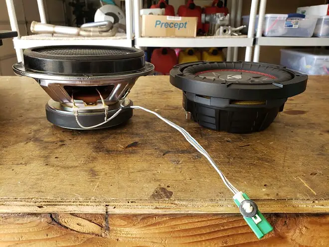

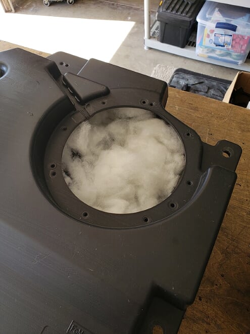

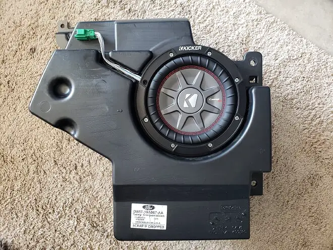

Did a stock speaker upgrade in a 2015 Explorer Sport with the Sony Premium Sound System. Simply upgraded speakers, using stock amp. Not the best "write-up" as it's mostly pix, but hopefully it will be a decent jumping off point for those interested in doing more. I just wanted a slightly better system as all my focus is on the performance (I'm not an audiophile, so my interest in this area is minimal). I left the stock center dash speaker alone, didn't feel like taking apart the dash, lol. Hope the pix help folks out:
Subwoofer:

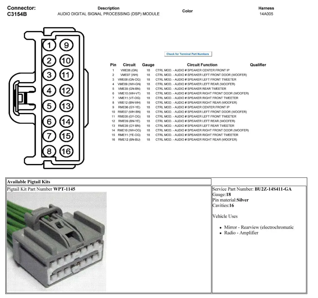

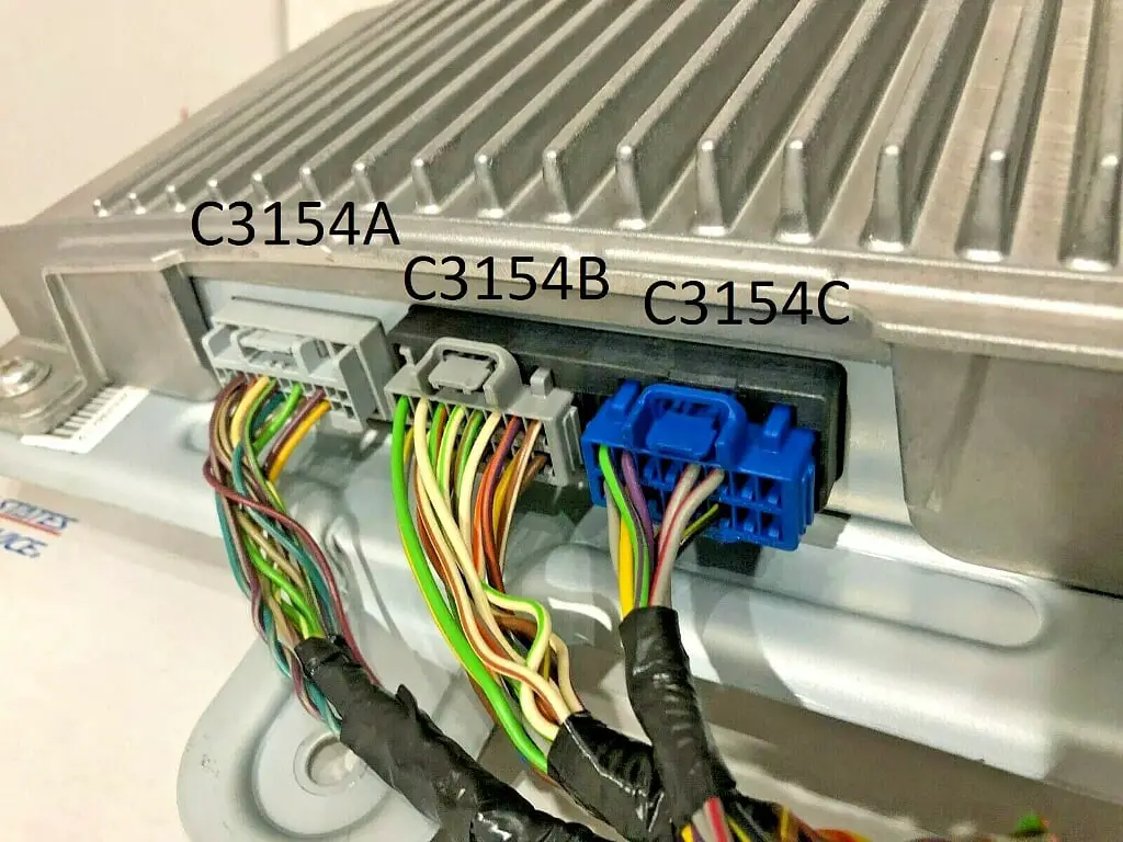

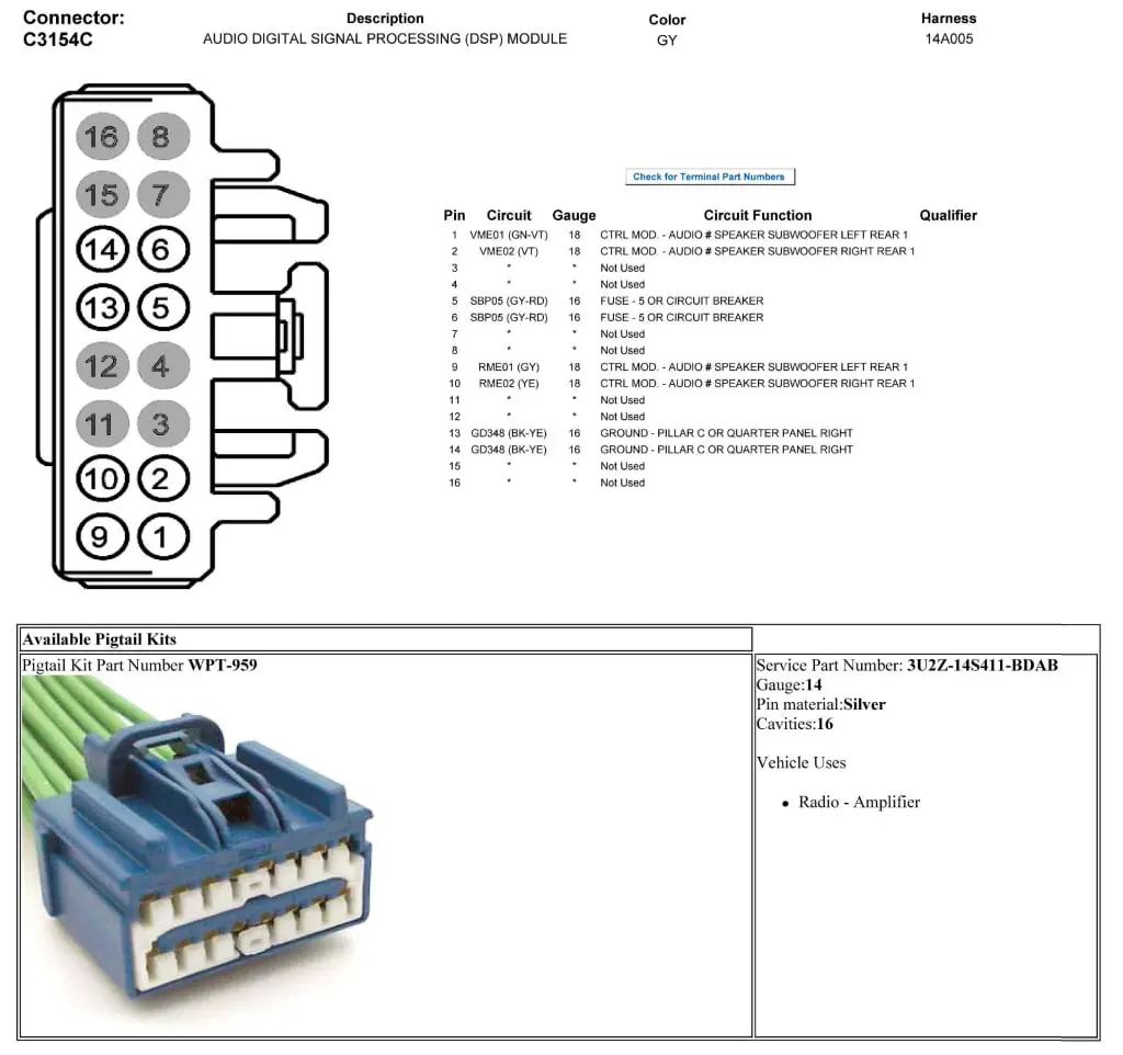

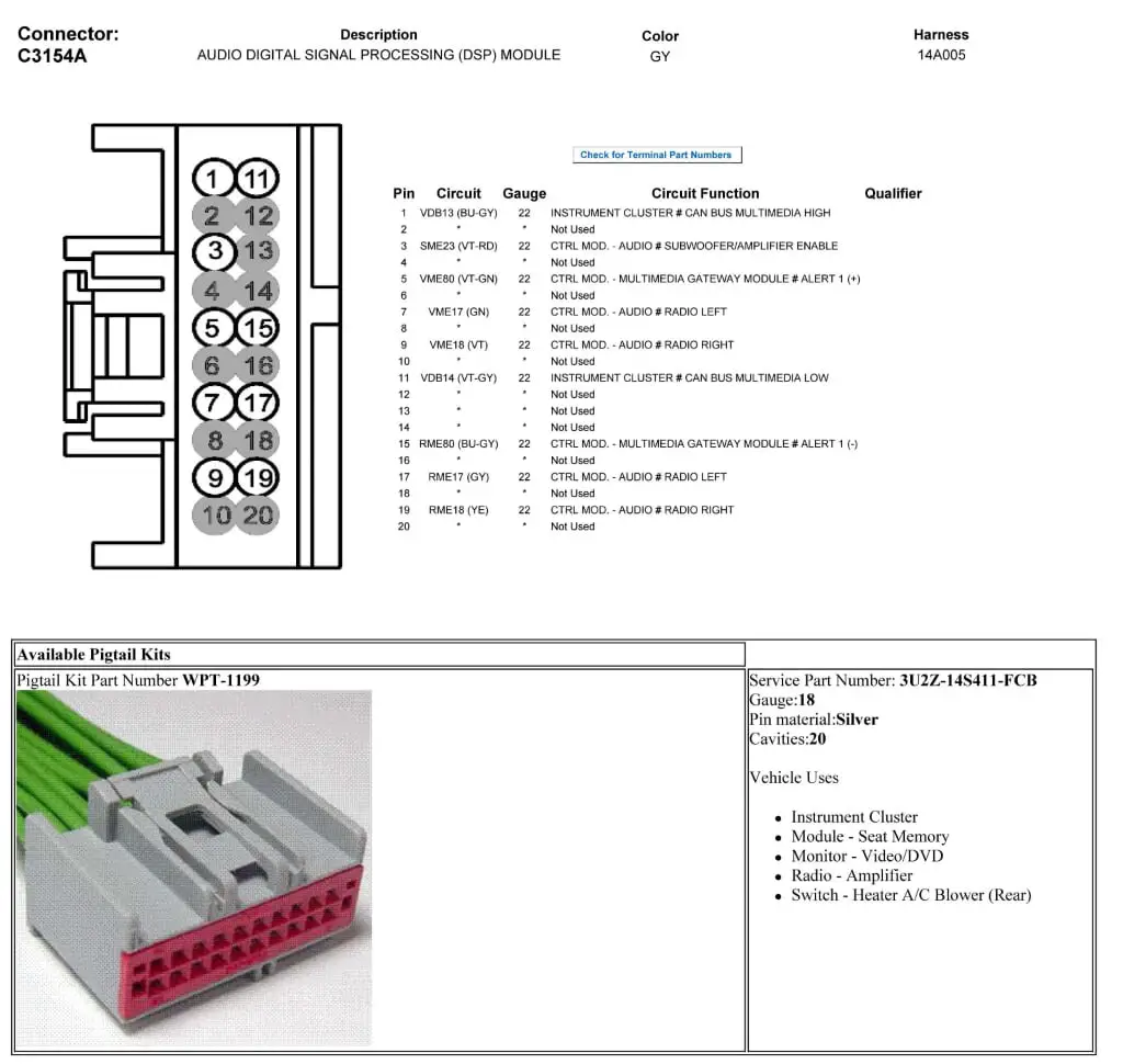

Every aspect of what you have done to your Expo has been hands down some pimp ass shit.. And I have been meaning to reach out to you about a couple things.. My main inquiry are your God Like Brempd Brake set-up. Im also in the now trying to do the same in that regard. Im just trying to get through X-mas and shit so I can attempot that Bad-Ass Mod...
In this instance Im despertly looking for Sony amp wiring pin-out... Any way you could help me out with that.....
Thanks for the compliments. Feel free to follow my Build Thread for all the deets! I try and update everything there nowadays instead of making seperate posts for everything.
As for your request...is this what you needed?

Sorry, Im an ID.10T....
I scrolled up earlier and saw what you left for all of us..lol
