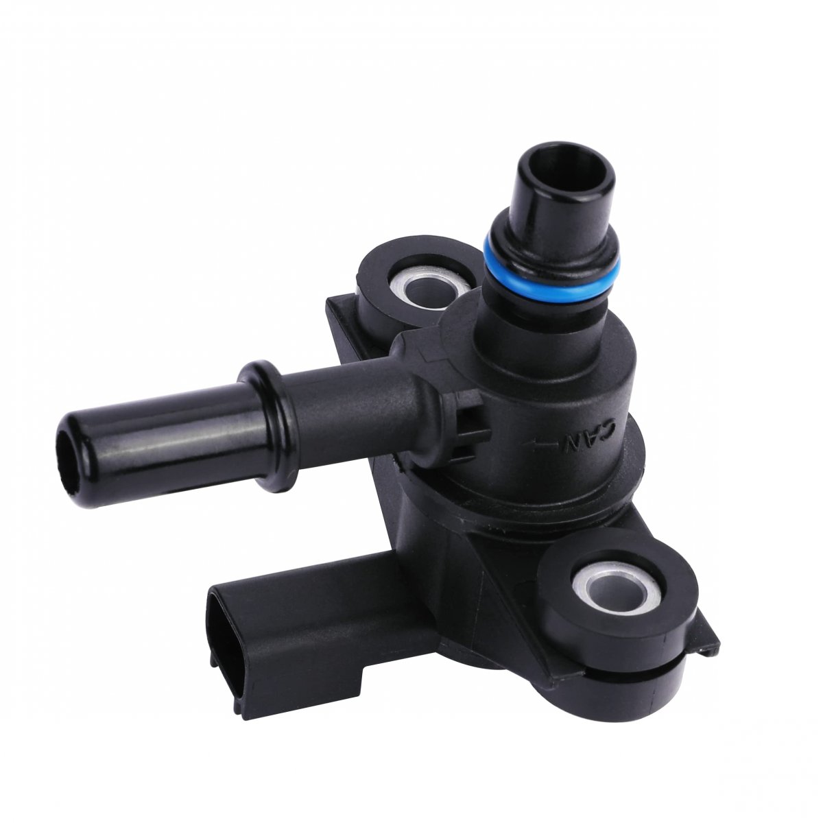

I replaced the vapor canister purge solenoid (attachment 4), and got rid of all but one of those DTCs, P0430, a Catalyst System Efficiency Less Than Threshold - Bank #2, which every now and then triggers my MIL to activate, which I normally just clear- again it's not an immediate issue and isn't causing any issues.

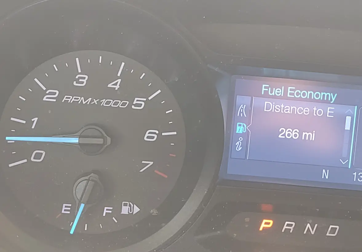

Bringing up fuel trim, however, I've had issues with my DTE calculations, where after filling my tank most recently, it says I can go 780mi till empty. I don't know if that has anything to do with the issues that could be going on, or if I've just got to reset my fuel trims every now and then or re-calibrate my DTE calculations. See attachment 7 and 8.
