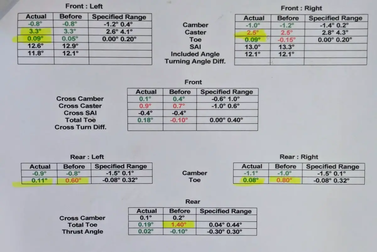

I am a Tire Specialist who has had a lot of time working with BMWs. Most of these come from the factory with the rear tires cambered pretty hard for better cornering. On the few BMWs that come with the same size tires front and rear, it is specifically recommended to NOT rotate tires because of this. Placing tires that have rear camber wear on the front can make the car handle very vague, and the car will tend to hunt in different directions given undulations in the road.
If you have had a rear toe link issue and worn the insides of the tires, then moved them to the front to try to get more life out of them, I suspect you may be experiencing some of this same issue. Even with a "good" alignment.
Quick update. Tire swap went fine. High of 77 degrees tomorrow, so hopefully we get fewer "summer" days and my winter tires don't wear significantly before colder days get here. Alignment was way off as expected, but I don't remember whether it was toe, camber, or something else entirely that I had too much of. When he was finished I was too tired and ready to leave the shop, so I didn't ask too many questions.
So in the end, I don't know whether my predicament had anything to do with the recall toe link replacement or not, but I'd like to think that me showing my mechanic the pics from J_C turned on a light bulb in his head and allowed him to make the adjustments that he previously said he couldn't do.
Here's the printout I got. Looks like toe was my main problem actually. He said the rear right wheel was off by roughly an inch, which obviously is not good. The "after" results make me happy.

Of note, I got roughly 75k miles off the tires from the factory (minus two winters that I was on my first set of winter tires, maybe 10k-ish in total). I got roughly 20k off of each of my two subsequent sets of tires, and the repair was done about a year after my 2nd set of tires (this was while I was living down south and only putting under 5k miles/year on my car at the time). Whether the recall had anything to do with my alignment/toe being out of whack is anyone's guess; the timing may or may not have been a coincidence.
I will say though, 9/19/22 all 4 tires were good, then roughly 8 months later (7 months after the recall repair) I was getting new tires installed and the Michelins were FLAT. I had to get bearings replaced - were they bad enough that they single-handedly trashed my tires? Who knows...
