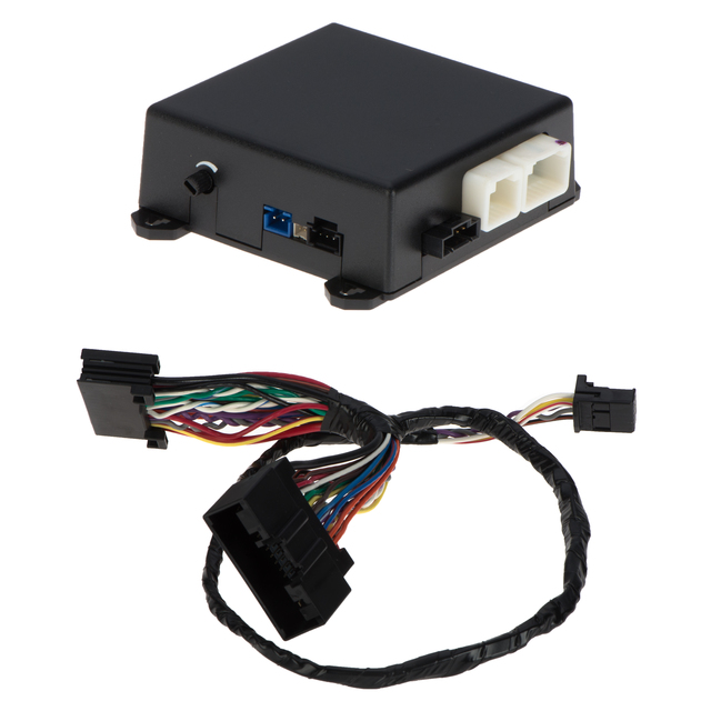

those modules are pretty straight forward as long as the correct one is installed. I think all years have a jumper pin if removed will activate the shock sensor portion of it (need to check install manual online). They hook up to the OBDII port under the dash and if unplugged should remove the add on alarm/cell phone etc portion of it without any further programming if needed, to test if that's the issue..

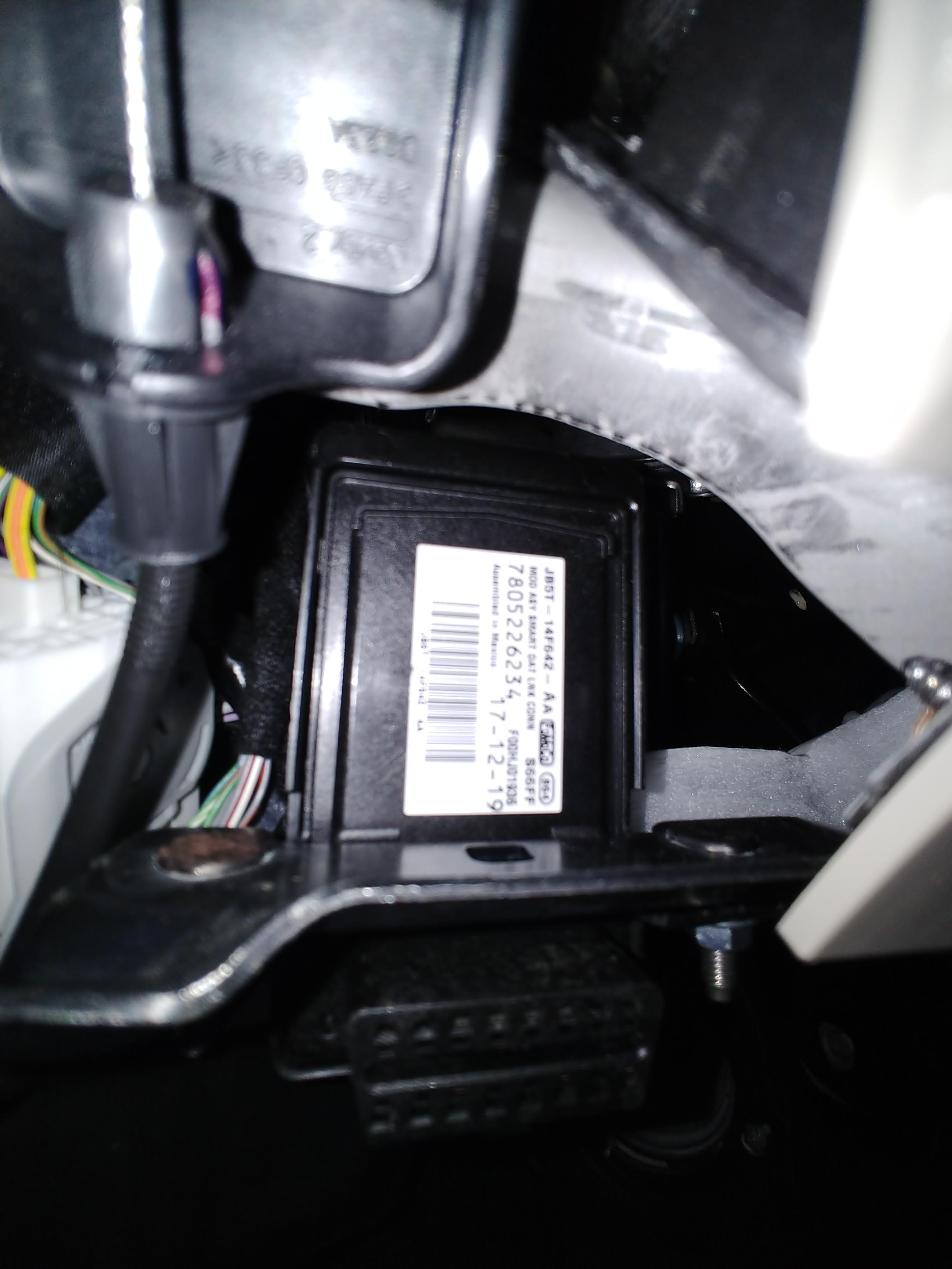

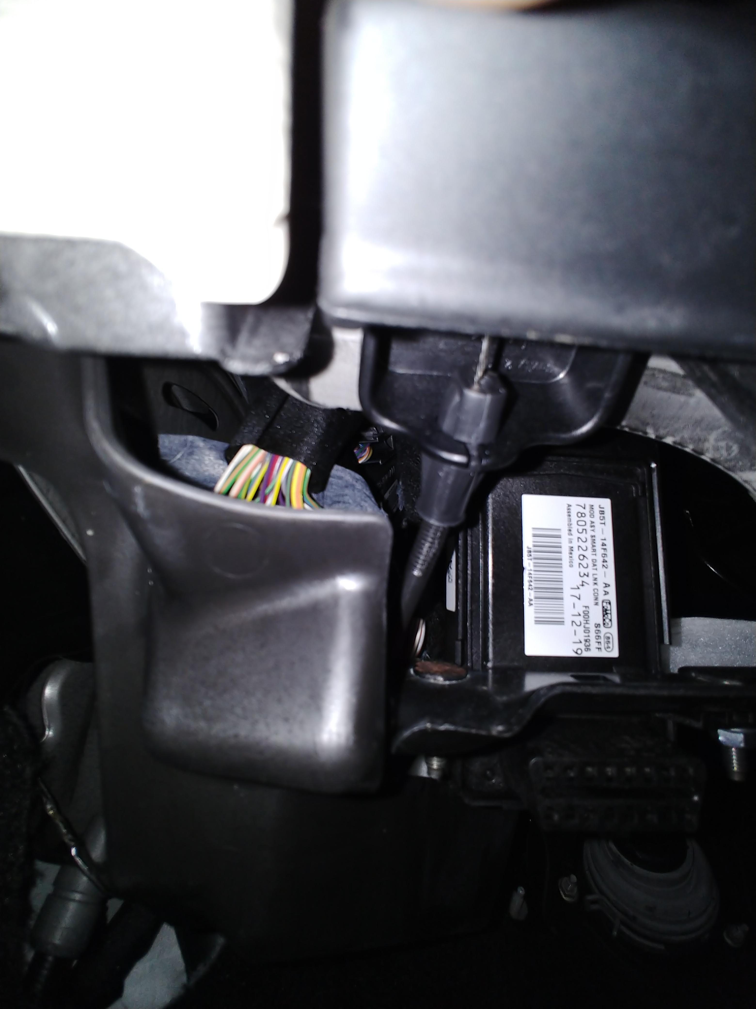

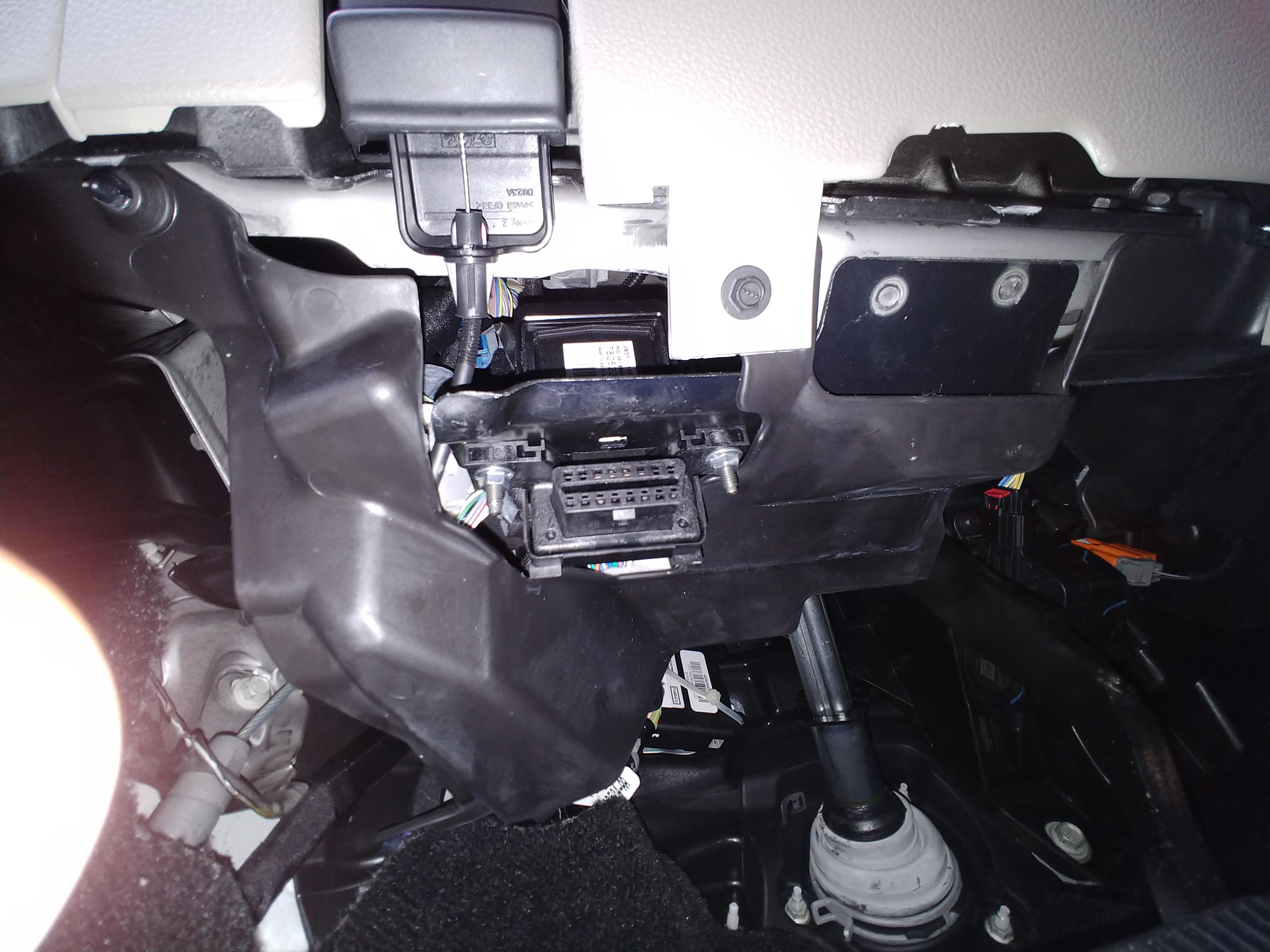

To follow up with jmr, I took some photos under my dash to see if they even installed the Perimeter Plus which they charged me $400...these photos aren't the best, but not sure where else to aim camera..can you tell if its installed, at these camera angles? thanks! before I trek to the selling dealer 80 miles away, Id like to know if they even installed it before I get into my alarm issues
I can see it in the last pic. Its the correct unit by the limited view. They sure did a crappy install (my opinion).
