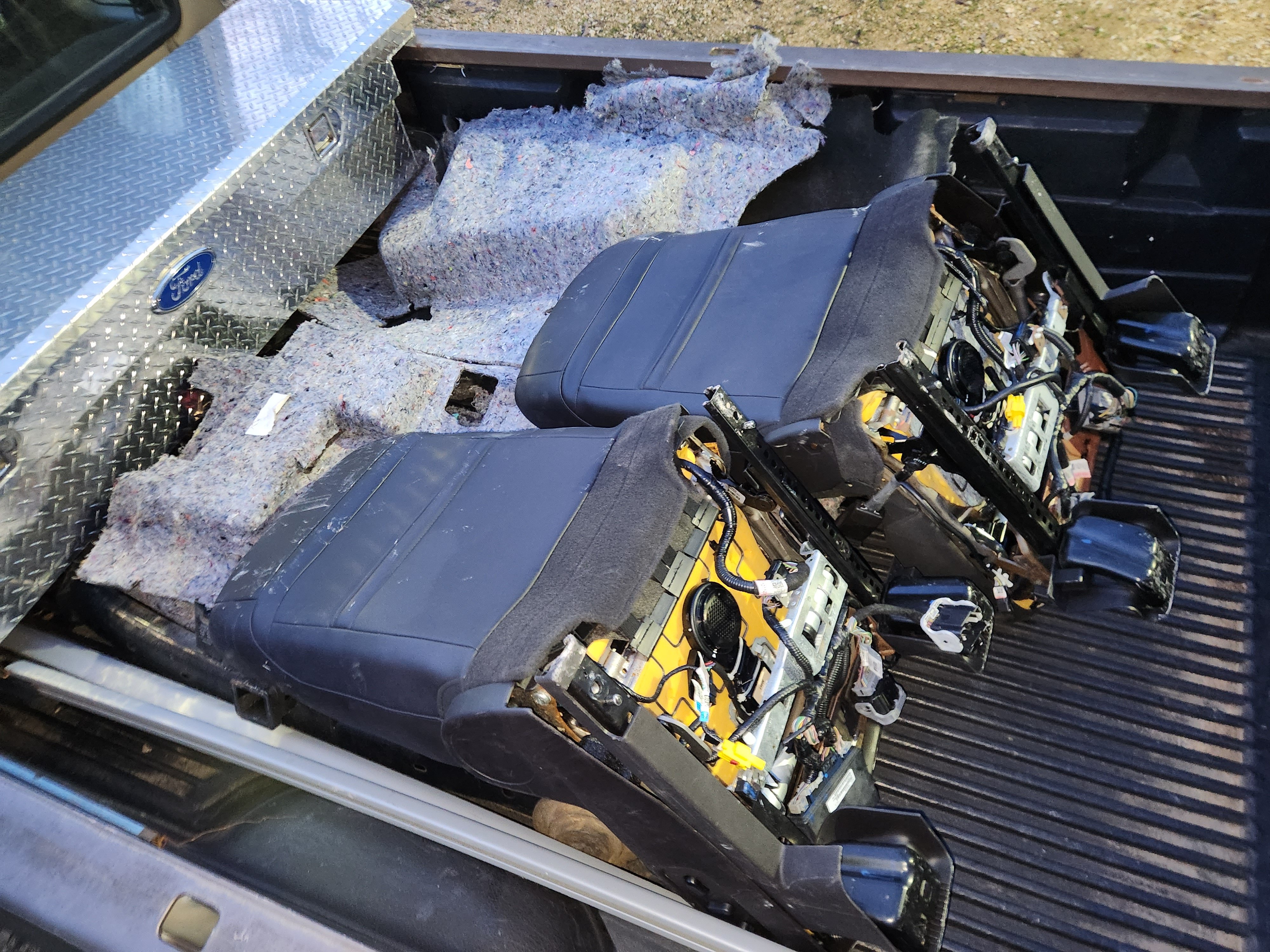

Hi explorers,
I wanted to make a knowledge post. I have a 2018 PIU it came with the standard cloth seats. I was able to source some 10 way electric seats from another 2018 explorer. However the seat rails are not in the same positions. The seat belt sensors are compatible I tested and no airbag error light came on with the vehicle running. The seats dont seem to have common attachment systems between the seat rails either. Best of luck!

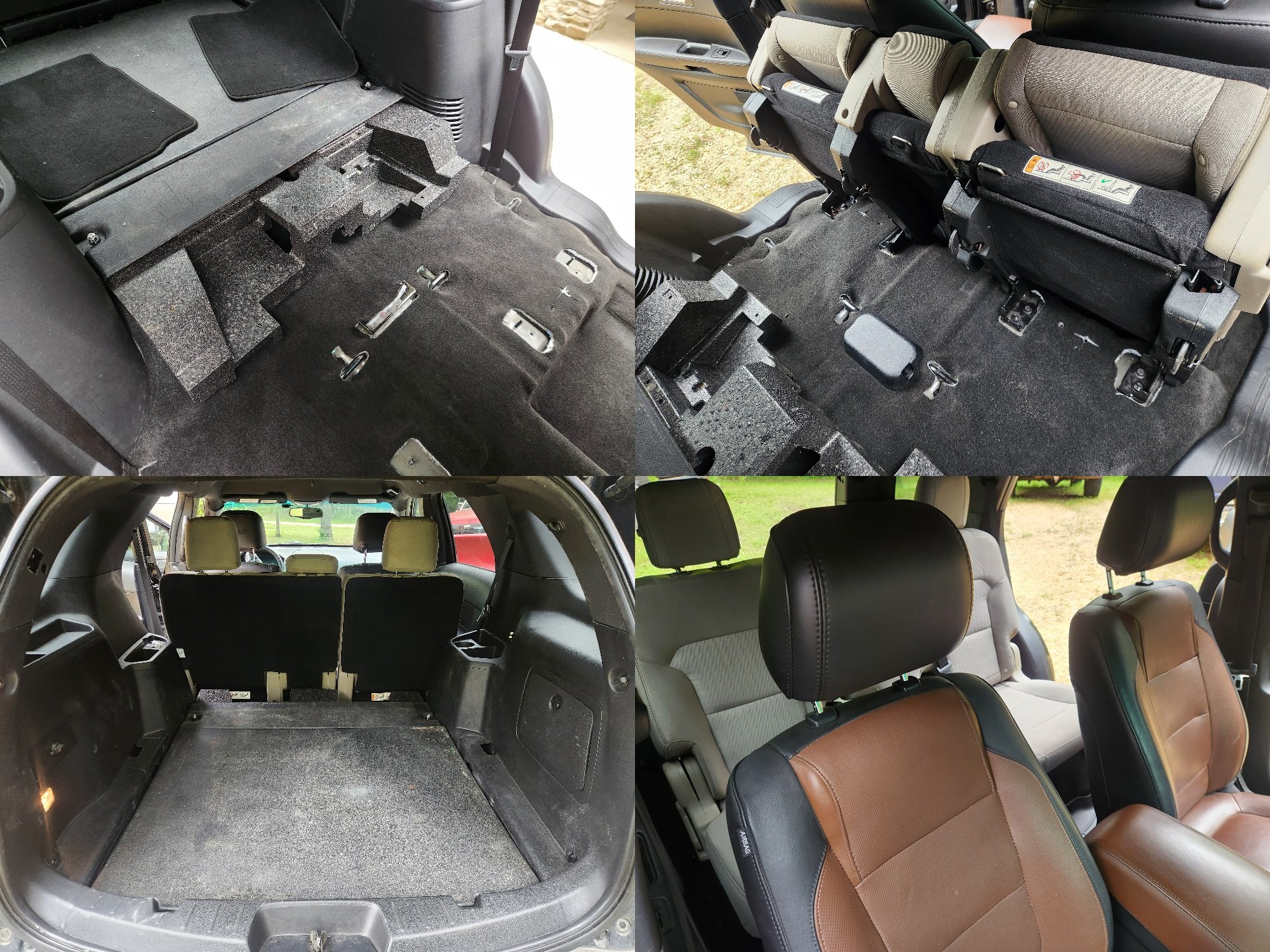

They didn't make a different floorpan for PIUs vs. Explorers - I had no trouble bolting '15 Ltd. seats (& console w/shifter) into my '16 PIU.
I also had no trouble bolting in '18 XLT rear seats & carpet, and all 4 floor mats.

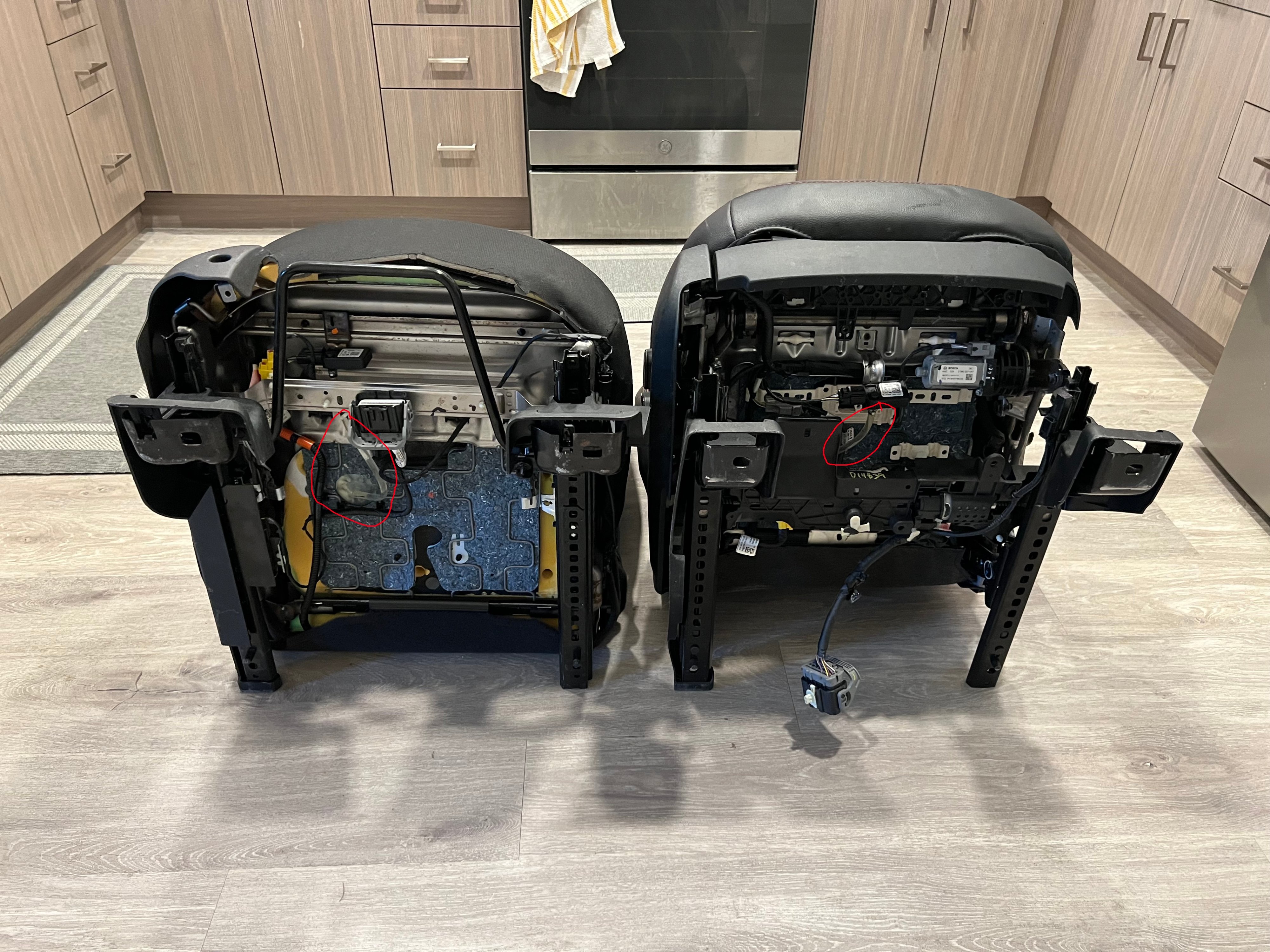

@Steve8316 Maybe the explorer sport has a different floor plan or maybe LKQ sold me the wrong part# seats? I dont want to use pre-2016 seats on my car because the airbag sensors are not compatible. I've circled the airbag sensors in red, they use a liquid that connects to the seat cushion.
Yeah, that's what's in my '15 seats. But I transferred the PIU's original pad into the Ltd. chair. It was very quick & easy - I only unclipped the front of the upholstery.
Looking at where the seats are bolted to the rails in the photo you uploaded. Looks like the same as the police seats.
Yes, all Explorer & PIU seats bolt down the same way, because all the bodies & floorpans are the same. That's one way to know for sure that the chairs you bought aren't from an Explorer: because they don't fit your PIU. Find the labels on them with their PNs, and Google them to find out what they came out of.
Of course the mounting points on mine look the same as the PIU seats - they're bolted down to the same places. The big difference is that I actually removed mine in the JY myself.
So I know what mine came out of.

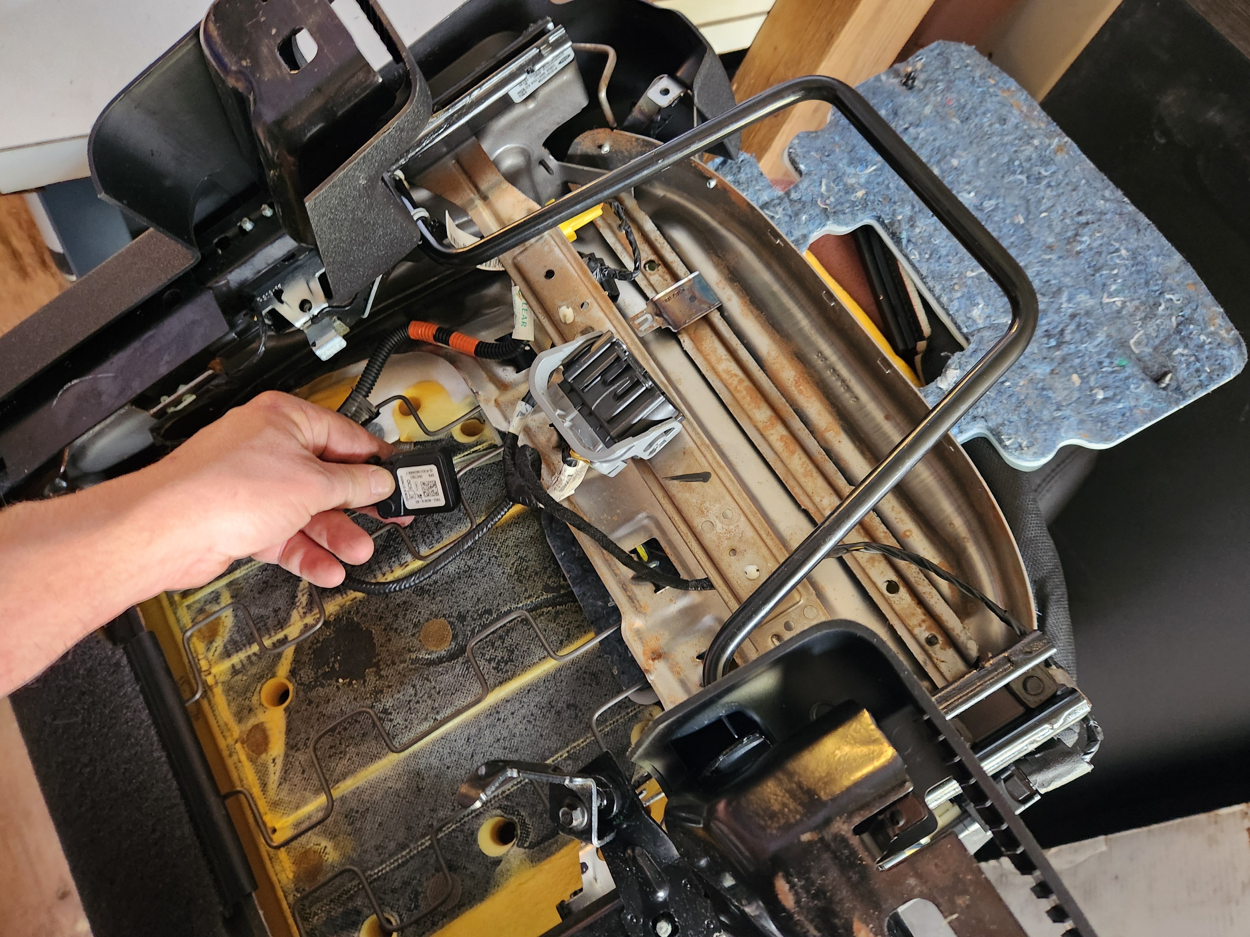

So I ran into a few issues. The ground on the 2018 10 way passenger seat uses a different connector pin position than on the piu seat. the PIU car harness uses a ground in position 5. On the PIU seat harness the various grounds merge into a single wire. IMG_0744 shows the splice. and then the black wire next to my index finger normally goes to pin 5 on C312. Additionaly. The OCS sensor & bladder have a different part number and the two bladders have different shapes between these two seats. The PIU bladder sticks out past the edge of the seat lip (img_0739) but it doesn't stick out enough from being able to clip the cover back into place and it uses plastic retaining pins to hold it on to the seat frame. Harbor freight's PITTSBURGH Automotive Plastic Fastener Kit had matching plastic retainers if you need to cut them out to remove them.
