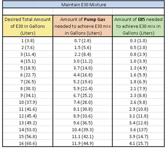

Thanks to Livernois for the quick reply and resolution, they got me fixed up quickly, much appreciated. Now I just need to figure out how to mix me some e30 :)
You are very welcome, happy to help out!
Thank you very much for the kind words as well. I've attached a E30 blending chart that's able to give you a general idea of how much E85 and 93 premium fuel to blend. Keep in mind this chart is based off of a perfect scenario where the 93 is E10 and the E85 is actually E85 which vary rarely is the case getting fuel at the pumps. I've heard from people in multiple different areas that the E85 at the pump is even lower than it usually is in the spring. I've been told this could be partially due to Covid causing a ramp up in production of things like hand sanitizers that require ethanol. So we always suggest if getting E85 from the pump and not VP Racing or something of that nature to test the ethanol content before doing your math to be safe.
