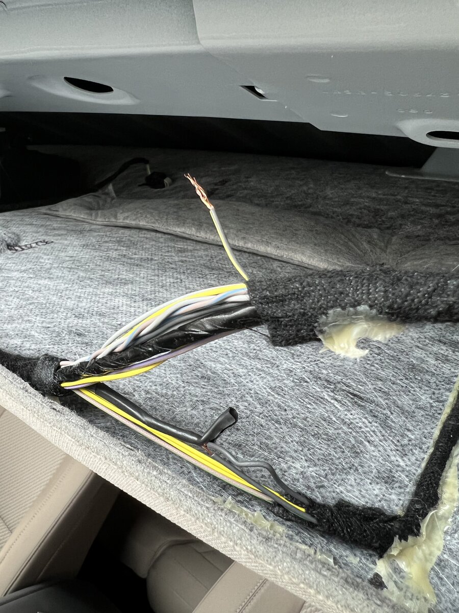

Found the issue with mine. Above the headliner, driver’s side, about an inch in from the sun visor arm mount. Ground wire was pulled out from 3 others and appears to have been sonic welded or something and heat shrinked. Reconnected wire and everything works as it should. 👌🏼

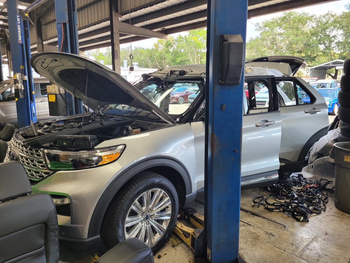

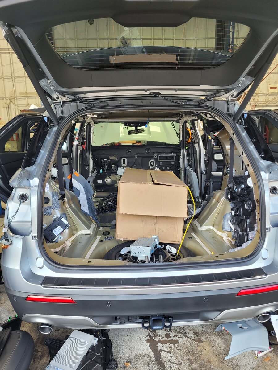

I drove off the lot thinking I didn't have a vanity light due to some setting... No dome lights, vanity mirror light, and garage home link wouldn't work. Dealership said the control module needed to be changed. It took a day to complete the work and I was called back to pick up. As I was driving off the right turn signal was not working. They changed the bulb and tried several different things before they put me in a loaner. That was just over 30 days ago. See photos of my brand new car several days ago. No end in sight. Ready to squeeze this big juicy lemon.
View attachment 435178 View attachment 435179
