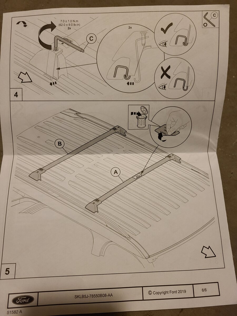

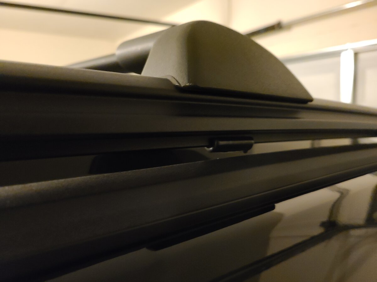

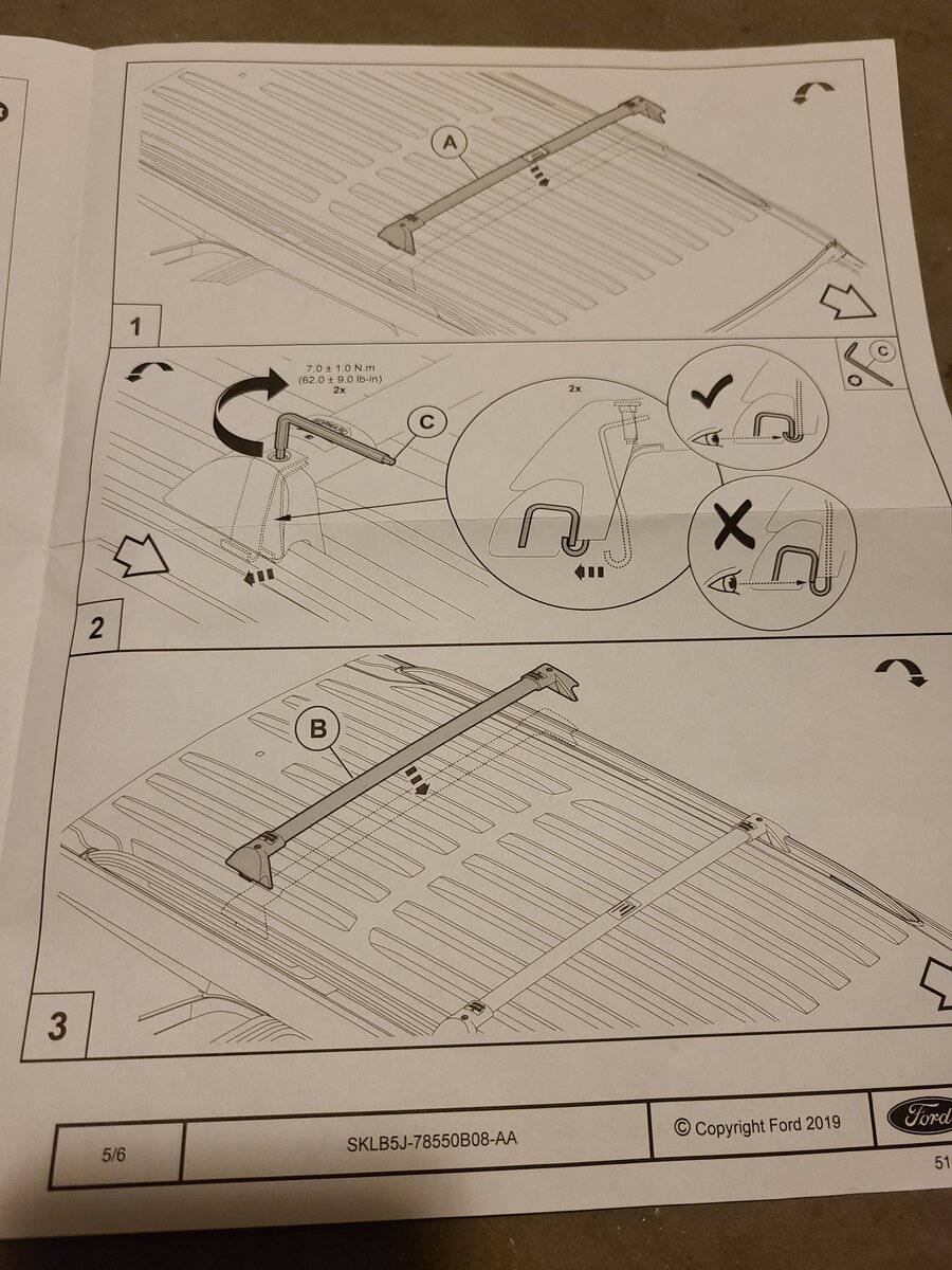

Can someone please post a close-up picture of how these cross bars attach to the factory roof rails. All the available images I can find appear to show the cross bars attaching to the inboard vertical surface of the factory roof rails but I can't see any way that attachment system would work with the roof rails on my 2021 XLT because there are no obvious provisions for installing bolts or brackets.
They just clamp on. You use an allen wrench to tighten the clamp that pulls up from under the roof rails.
Welcome to the Forum. :wave:
Thank you for taking the time to post the above. That should be very helpful.
